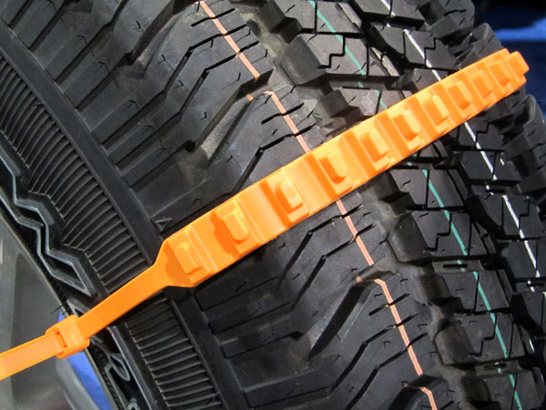

Kinda cool looking. I wonder how durable they are.
Nothing like old school CHAINS on all 4 tires. I carry a full set in my truck for emergency use.  Offroad mostly in snow.
