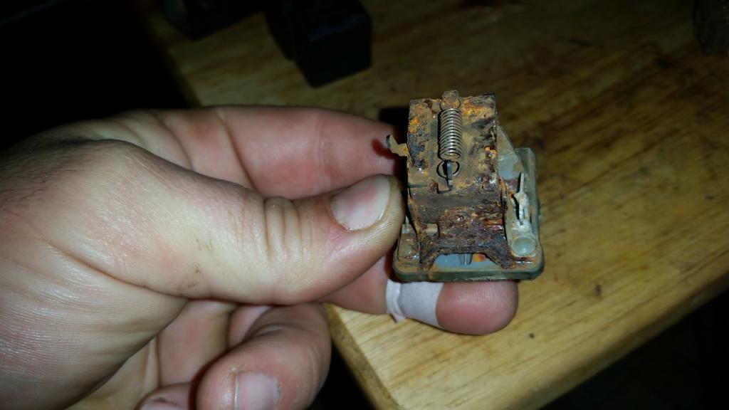

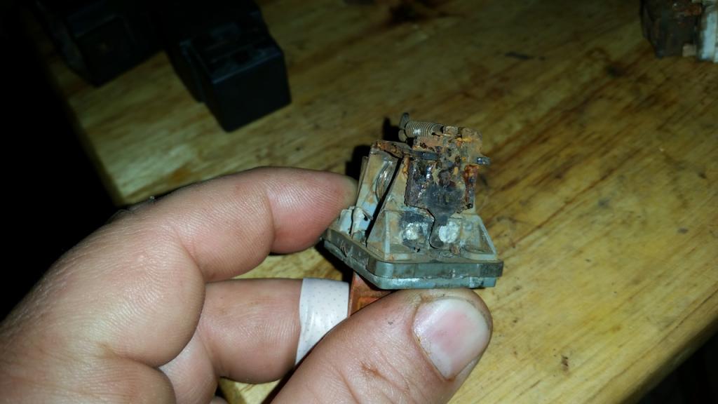

That's my fuel shutoff solenoid relay lol. I've a got a couple new ones on the way from Larry B, until then it's the ol' "pop the hood and push the rod" routine.

Apparently I didn't check the "notify me of replies" box when I posted this. I thought no one had ever replied lol.
Yeah, those solenoids must have been toast for a good while now. I found that the previous owner had a wire running from the starter relay to the FSS, completely bypassing the FSS relay. That wire ended up coming loose causing my FSS to no longer function without a literal helping hand. I now have everything properly repaired and a new relay from Larry B installed. It's a good feeling with you un-eff things back to the way they're supposed to be.

Being a 12V fuel shutoff relay is located on the cowl on the driver side about 1/3 of the way over. What make the difference is if the relay is hung up-side-down which will allow water to leak into it. Also if your missing the cowl weather strip this problem is worse.
