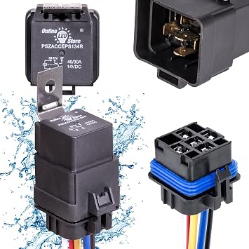

I just got this weatherproof relay and the Blue Sea waterproof fuse holder from amazon.
Both quality parts
Both quality parts
Glad to hear it. Amazon is a good source.
Red good find in those two items.
