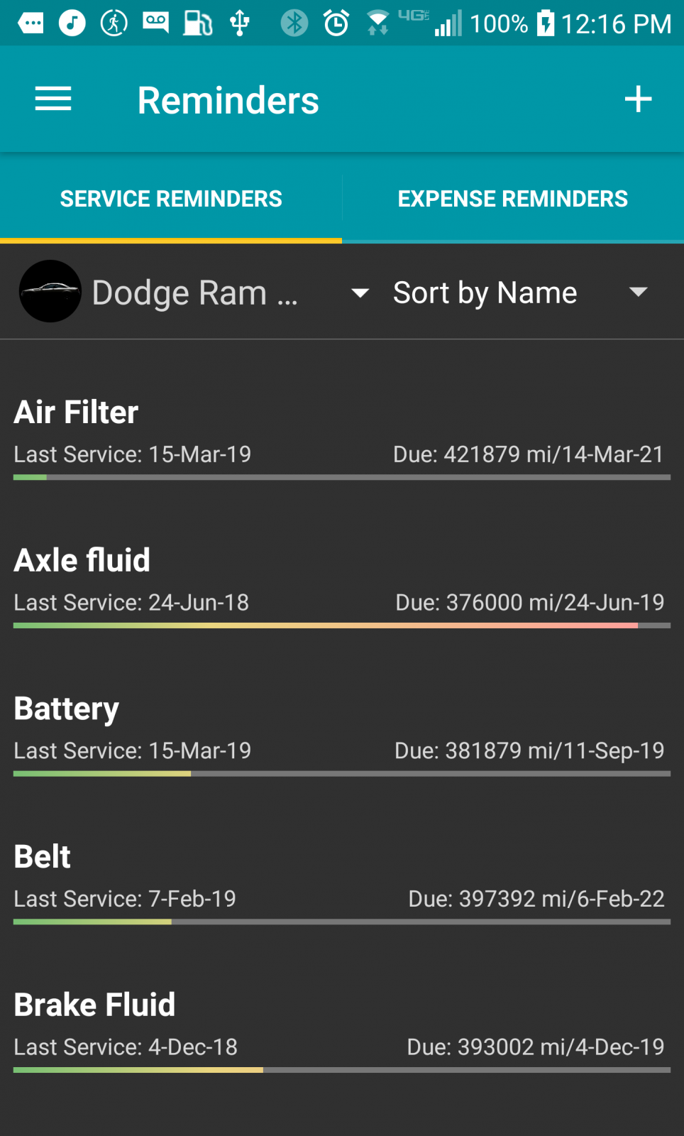

You need an app called Simply Auto for your phone so as you track the fuel mileage it reminds you to service different things.
