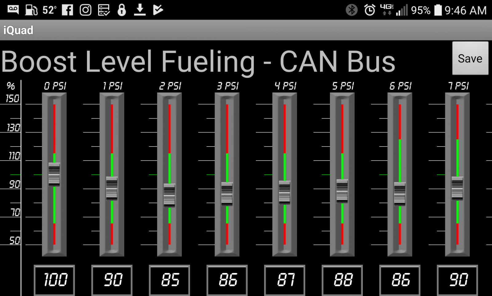

    If your maxing out your canbus, 4095 is max and need more power, that's where wiretap comes in. With bigger injectors I use canbus for the most part.
