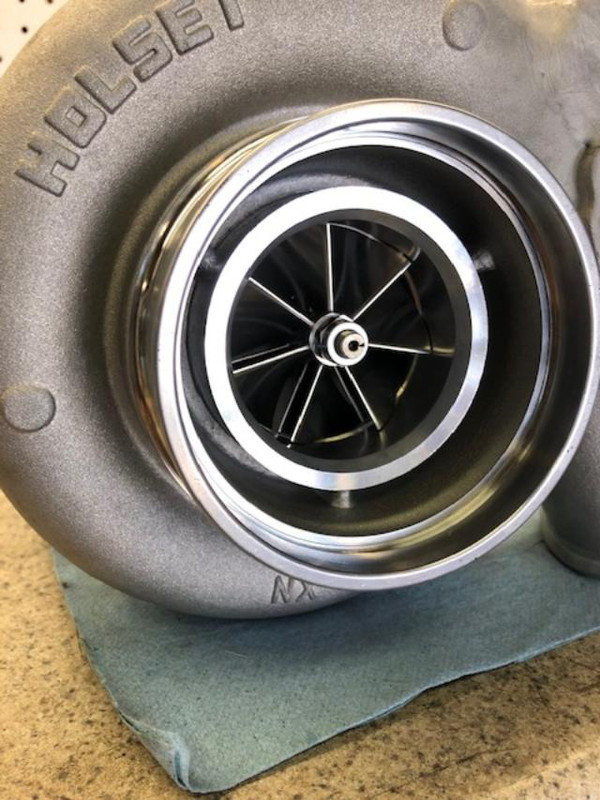

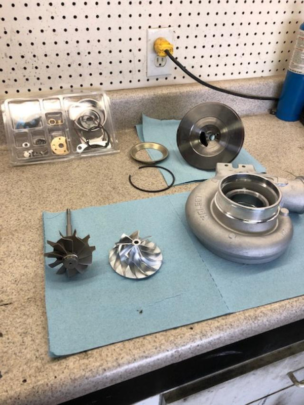

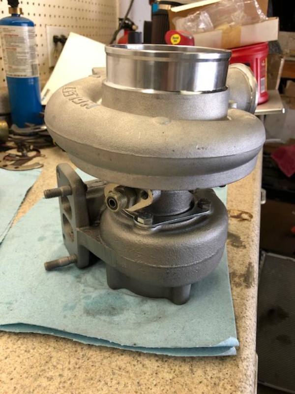

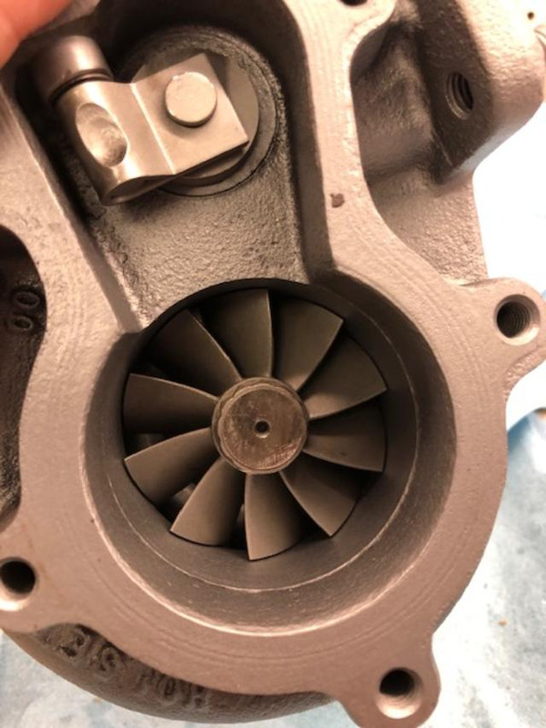

I am going to build a hybrid hx35/40.  Well.. it'll be mostly HX40 with the only 35 carryover being the turbine housing.
As much as I searched, it just does not seem like there is a reasonbly priced turbo between an HX35 and a 62/68 BW variant that everyone seems to love.  As cool as a BW 62mm would be, i just dont need that much turbo, i dont want the added lag, and my truck's primary function is towing my 5th wheel toybox which is around 13k loaded so i need the turbo to spool reasonably quick.
I ended up buying what is basically a new, un-assembled complete hx40 without the turbine housing (ill be reusing the 12cm 35 housing).
Specs:
--10 blade 64mm hx40 turbine
--60mm billet hx40 compressor
--new center section
--new compressor housing machined to match the billet compressor
I just dropped off my turbine housing at the machine shop to be bored out for the larger turbine wheel.  Hope to pick it up tomorrow at which point i'll assemble the turbo and install.
Couple pics

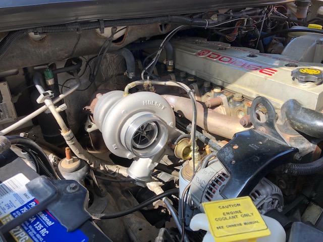

    Well i got her all buttoned up and running.  Local turbo shop was able to open up my hx35 12cm turbine housing for the new 64mm turbine wheel.... only charged me $40 to do it.   First impres
  • gimmie11s
    gimmie11s
    Quick update, i towed my loaded toybox (almost 14k lbs) 6.5 hours last weekend and absolutely no issues.   Turbo worked fantastic.. EGTs on the uphill climbs never over 1100 on quad level 3

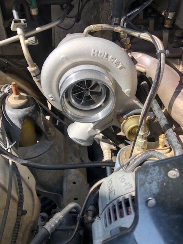

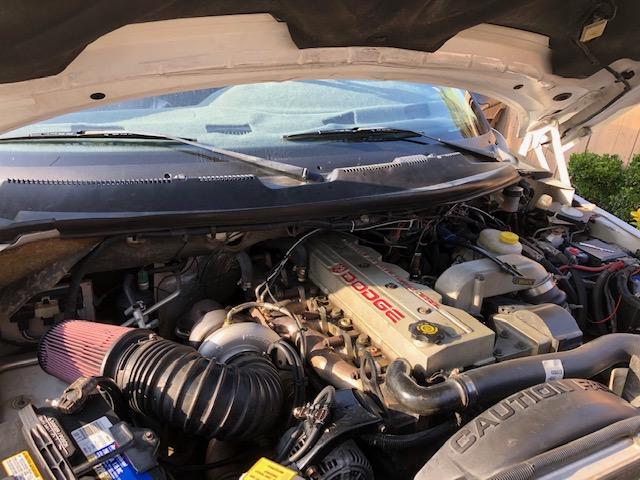

First impressions... WOW!  Absolutely love it.  The boost threshold has moved up in the RPM range by about 200 RPM.  Where the hx35 was making steam around 1600rpm, this one is coming on hard at 1800rpm.  I can control boost pressure with my right foot around the 1950-2000 rpm mark (this is where its "on the pipe").  It really is perfect for my gears and how much weight i tow....
With the hx35, the most boost ive ever seen was about 33-34 under heavy load on max default Quad setting (level 10).  EGTs would skyrocket quickly and I'd have to let off the throttle.
First drive with the new turbo and boost blew past 40psi almost immediately and I let off.  Pulled over and turned down my boost pressure (adjustable boost controller) so it maxes out around 35-38 psi.   I was originally considering going non-wastegate.. glad i didnt!  This turbo would probably make 50 psi.
I can now run level 10 on the Quad all the way to redline and EGT barely creeps past 1200 degrees with boost being around 37-38 psi.
Amazing amazing upgrade!  With any luck, next week i'll be installing an NOS pacbrake i bought off offerup last night.  Should be a perfect combo!
