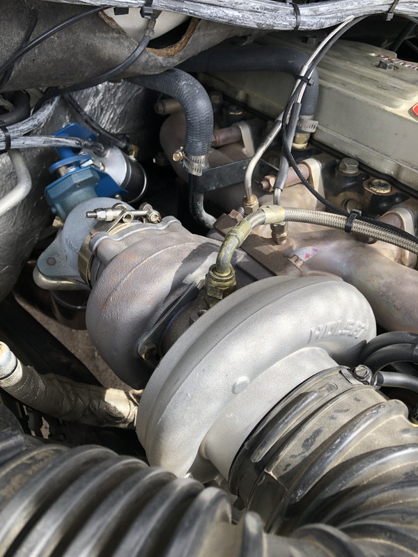

My Hx35/40 hybrid build
Had to change things up a bit when my used Hx35 showed up rusted as **** and the wastegate diagram was toast. Was going to be a 62/64/12.  Everything new now. 62/67/12. Will be assembling tomorrow and hopefully installing it.

She’s like a rocket ship now! My son was driving I told him to get on it a little bit. Didn’t have enough hose to hook the waste gate up yet so there’s a little bark at the end. Sorry about the glare.

On 4/18/2020 at 10:35 AM, Threadzy said:
They are Turbo Lab parts.
I heard mixed reviews about them a while back, hopefully they got better over the years.
Hopefully! Time will tell. I’ll keep everyone updated.
It will be fine.  The parts turbolab sells are quality parts.  Ive assembled 4 turbos from him in the past 7 years and EVERY one of them is still going.
It would be good to have your turbine and compressor wheels balanced before you assemble though, just to be sure.
I had that done on mine when i had them open up the turbine housing.
