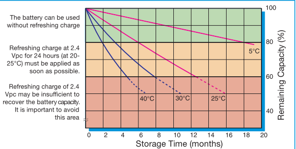

3. What could draw those batteries down and ruin them like that with the truck not being active? I know it’s possible under normal circumstances for batteries to discharge over this much time without a trickle charger, but something pulled them down and ruined both of them. I checked all the grounds i could find and they’re all tight. Some have light surface rust from being 20 years old and the one by the power steering pump is caked in oil/dirt but all are tight. I have during this time put in a fuse on the blue wire pin 25 out of pcm harness, and i will probably do the W-T ground mod if I can find a video and/or follow a good set of instructions on it.

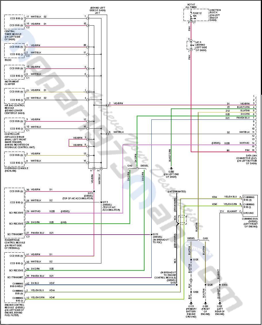

EVS? I'm not sure what this device is. PCM is the master computer that starts the CCD network bus and ECM boots up separately. As for the entire network and what is there.
ccd network wiring

The batteries going dead after sitting unused that long, new or not, will go dead.
Thanks for the schematic... I am a little inexperienced when it comes to wiring diagrams and such but I’m a moderately quick learner (I think..).  The EVS II was a dealer provided security system with keyless entry, alarm and anti-theft module. I think they phased out in the next few years after I purchased it. It had always functioned perfectly until this storage period. After replacing the batteries, the EVS was all out of whack. The keyless function wasn’t working right and the alarm could not be disarmed so it would go off as if I were breaking in no matter what i tried. So I removed the whole thing.

Are the ECM and PCM not within the same device/box on this truck
ECM, Engine Control Module, located on the left (driver) side of engine.
PCM, Powertrain Control Module, located on the right (passenger) out side fire wall.
Yeah, I wasn’t really surprised they were discharged, but they were completely gone and also not recoverable which I haven’t experienced on a vehicle before and I’ve had others in storage situations without ever losing a battery entirely. I wonder if there might be a parasitic load on them though and that would seem possible.. I wonder if that could have been a result of something happening in the PCM/ECM

You didn't say whether  or not you disconnected the batteries for the time  period your truck wasn't being used, so I am assuming that you did not.  If you did not disconnect the batteries, then they could have completely discharged just from the parasitic draws from the many control modules that go into sleep mode after the engine is shut down.   This would include your security system, as well.
