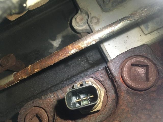

Before buying a new MAP sensor, try pulling it off and spraying some wd-40 inside to break up some of the carbon and grit that may be in there.  Use some compressed air to d0uche it out real good afterwards.  I believe its a deep 30mm socket to get MAP off.
Worth a shot before spending $$.
Edited by gimmie11s
correct spelling on "believe"
Yes I tried this last night.
the sensor was spotless.

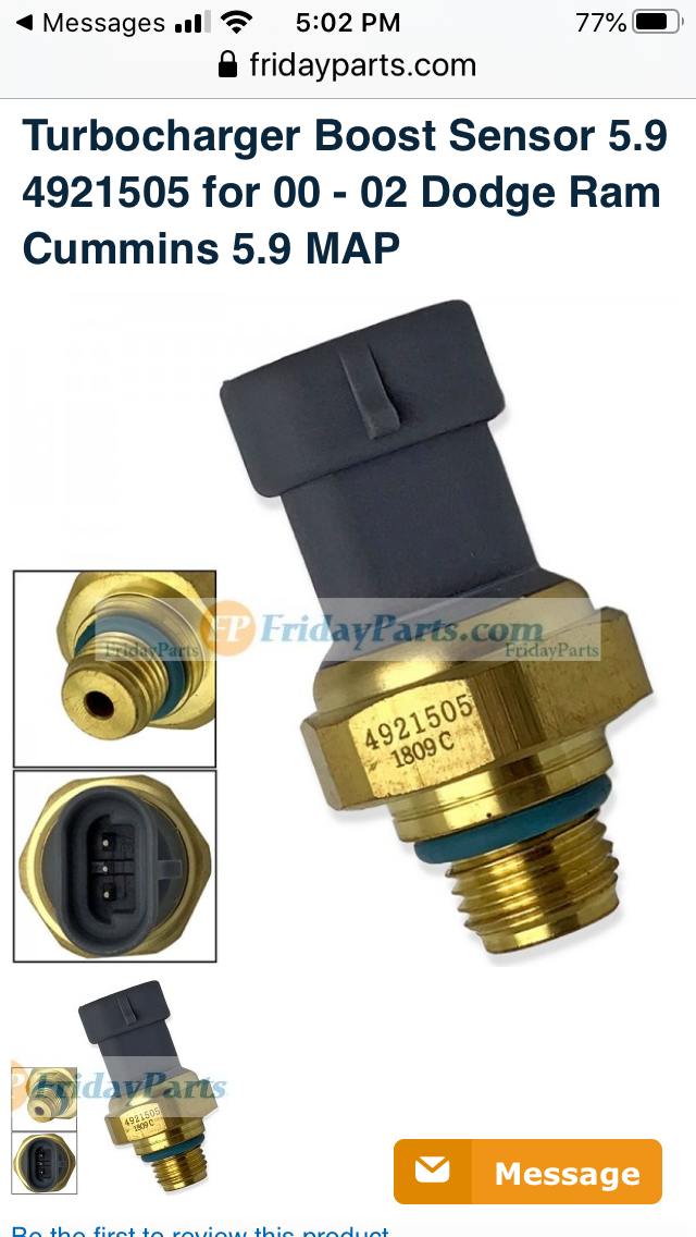

I did find the map sensor online for 15$ US.
so I ordered 2.
With shipping 53 US$
about 70 Canadian.
I may have to buy the adaptor cable???
thats about 80$
So all said and done about half price as what I would pay at Cummins.
OR 1/4 the price of the dealership.
thanks for your help
i will let you know when I have the new parts are installed and how it worked with the issues I’m having now
What kind of MAP sensor did you find for 15 bucks? And an adapter for 80? Thats the opposite of any I have ever found.
Friday parts . Com
p/n-4921505 that’s their and Cummins P/N
and the dealer / Chrysler sells the adaptor for
around 75$
Check it out and let me know what you think.
I just goes to show you how much people mark things up
