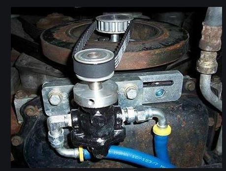

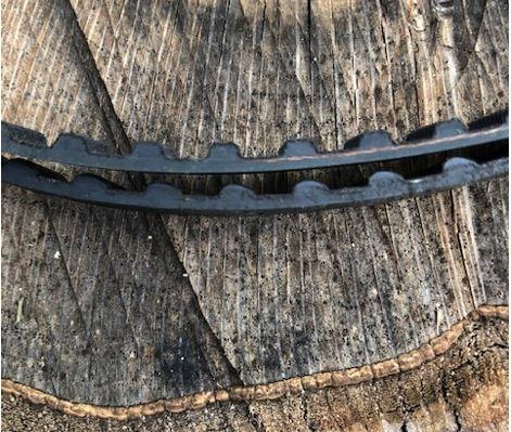

I'd be looking at the fuel pressure regulator, filters/strainers, drive belt, etc. Of course checking with a mechanical gauge or other known gauge would be a good idea, too.
Your sender seems VERY well protected. My ISSPRO sender doesn't have it that safe, with 60k miles on it. How many miles are on yours?

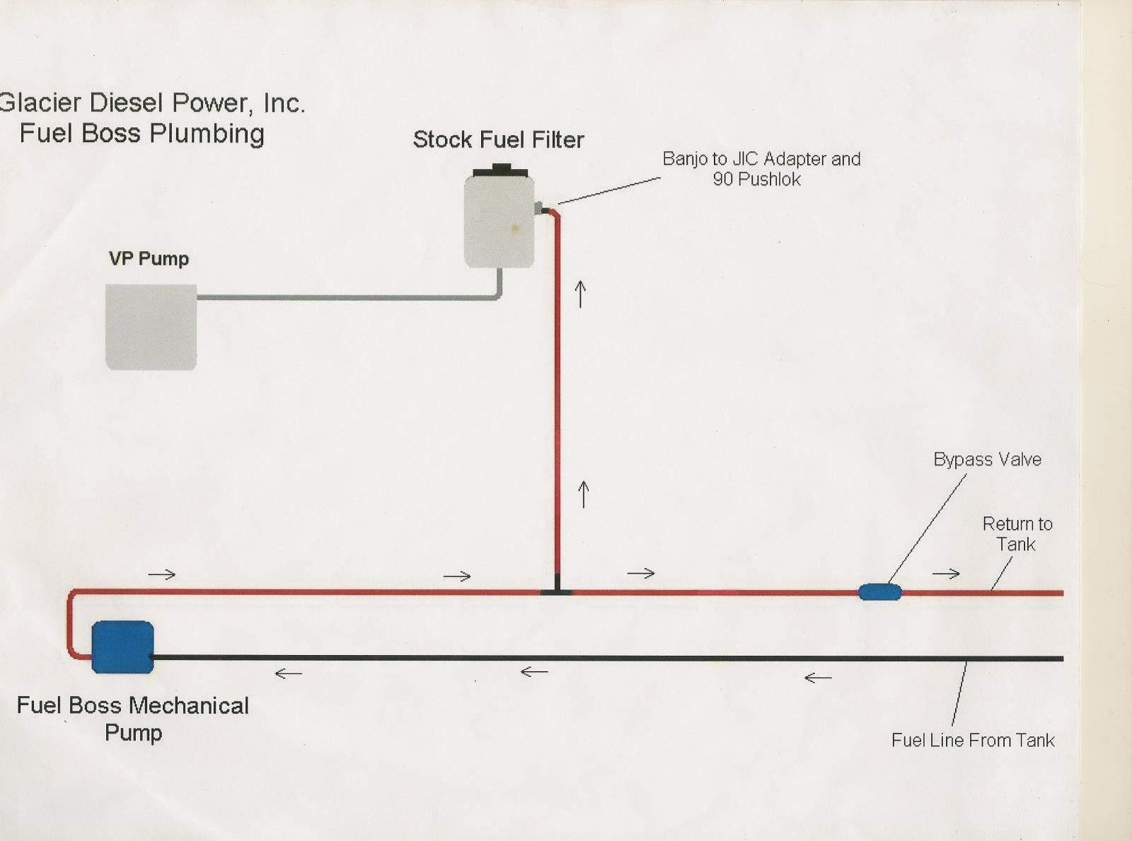

Maybe 10k max. I did change the stock filter as well, and it has a new return line strainer as well. I went through 3 isspro mechanical gauges that were protected in the same fashion, and they all would start sweeping while driving, going bad. How far open does everybody have their needle valve? On my return line it has a check valve that allows you to raise or lower the fuel pressure. I have pulled it twice and checked for debris, however it was clean.

I guess I might be looking at getting a new needle valve and redoing my gauge inlet side of things. I just recently have a new lift pump and fuel sending unit. I am honestly tired of fuel related issues! The only other thing I might try is getting a new check valve from glacier diesel as that is the cheaper part compared to the sender. I don’t think my sender should be bad this quickly. My current needle valve is 1/8 open.

I will give it a shot, see if anything changes. Could be the sender, the check valve, or mechanical pump. It has all new filters currently. My only other thought is possibly air in the system but it is running just fine.
I feel pretty confident it isn’t a ground issue. I have checked all my wiring and it all looks just fine. I have unplugged all gauges and they come back on just fine. Just low fuel pressure. Pretty sure I am going to need to spend some coin to isolate the issue. Dang it!
