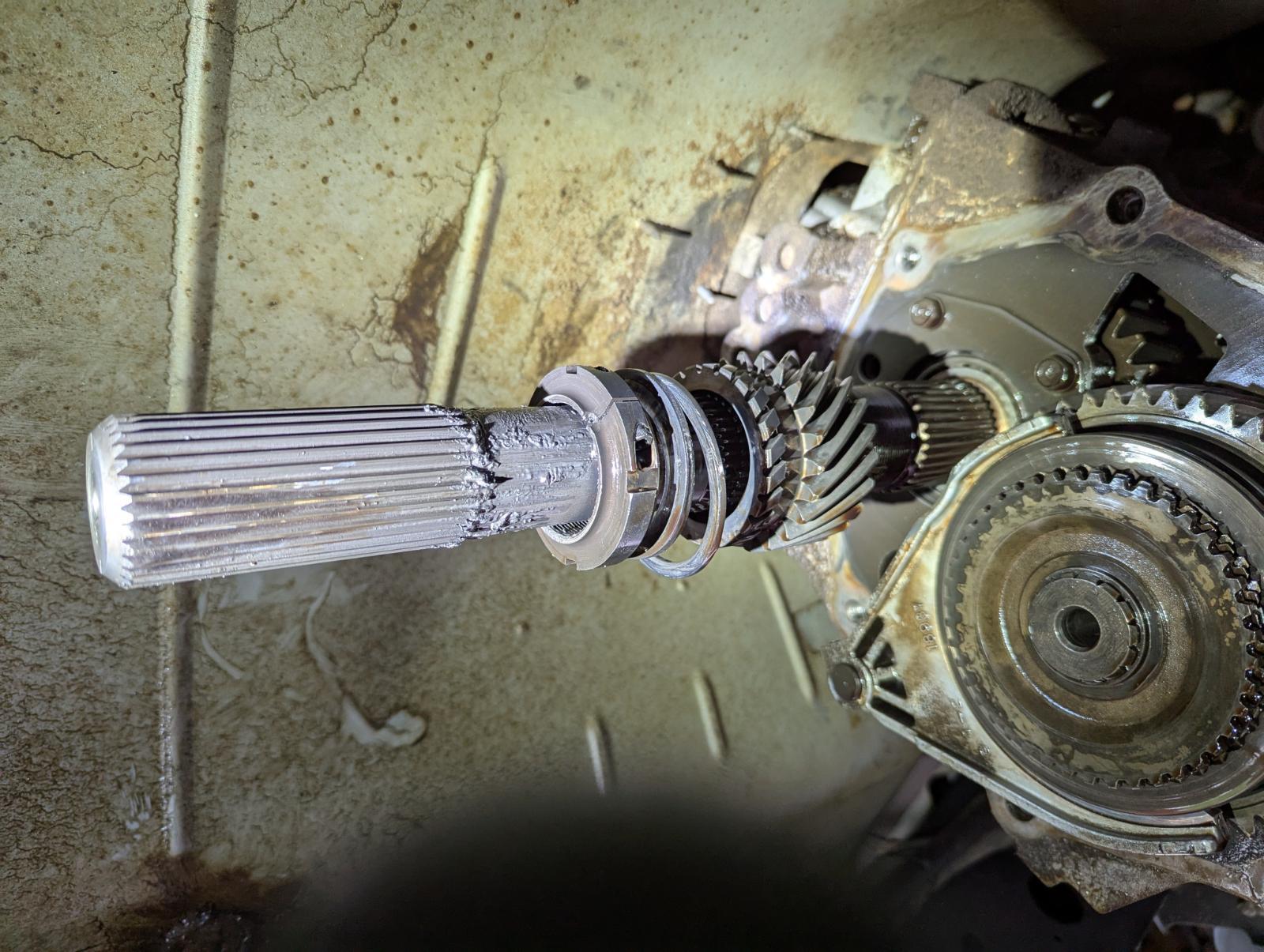

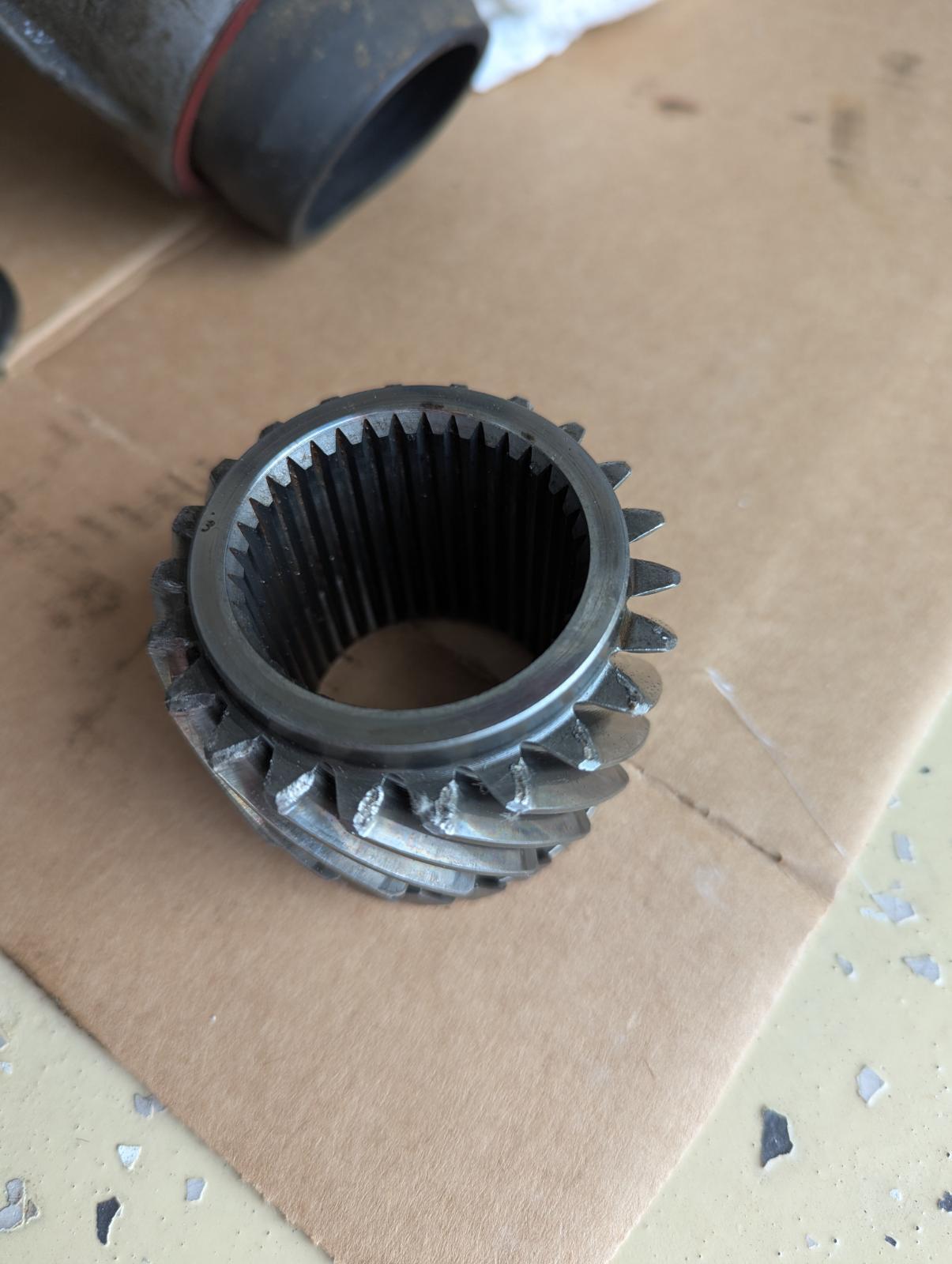

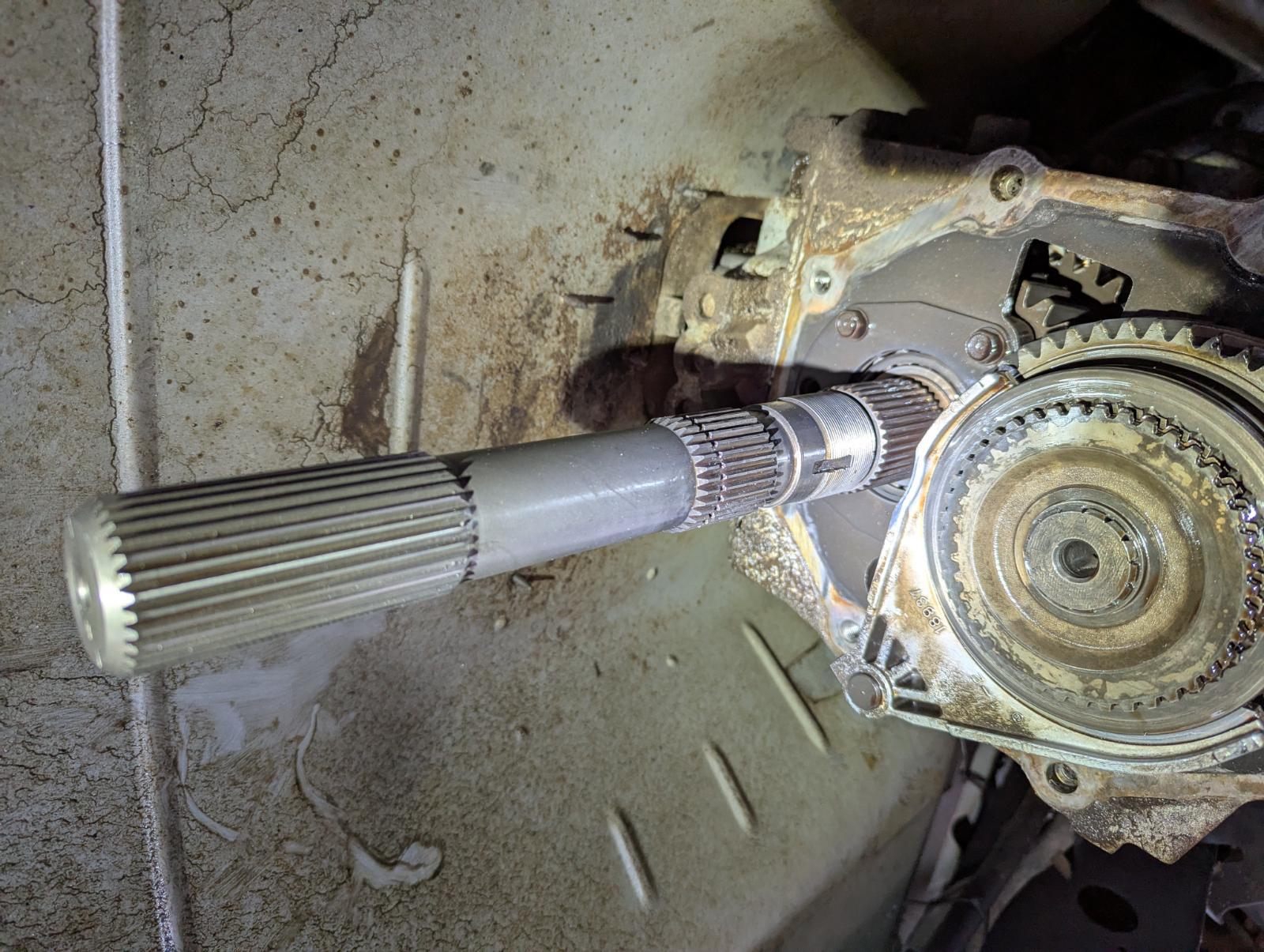

I was trying to figure out all my options. Like if I wasn't able to get get the parts in time or if the main shaft spline was shot. Turns out that's not the case, as you can see below. Oh, and thank you for your article on removing the tail housing, that helped a ton!
During disassembly some of the bolt didn't match the article buy @Doubletrouble, leading me to believe it's been rebuilt at least once before and after getting the tail housing off, it's clear it's been rebuilt. It has a fully splined mainshaft and updated spit nut.

The gear slides right on the spline of the main shaft and I couldn't feel any axial play. I realize it might be so small that I couldn't feel it anyway, but no noticeable play was a win for getting this thing back together and home.
Given the damage to 5th gear, I'm going to get a new 5th gear. I'm also thinking about having a machine shop grind down the lip on this nut, reinstalling it and putting a new nut behind it as a jam nut.
Any recommendations on where to get the new parts and/or my plan would be appreciated!
