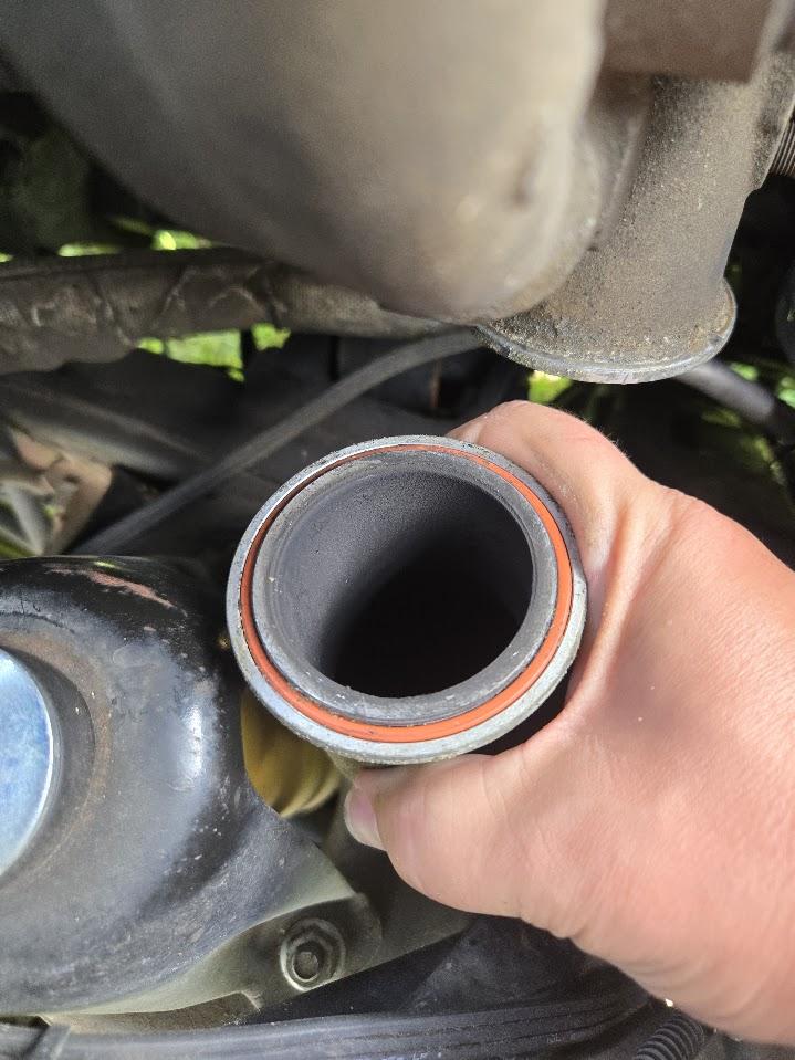

    Observing soot at the end of the tailpipe is normal for this era of truck, especially if you have larger than stock injectors. Disconnect the compressor discharge plumbing from the turbo and inspect

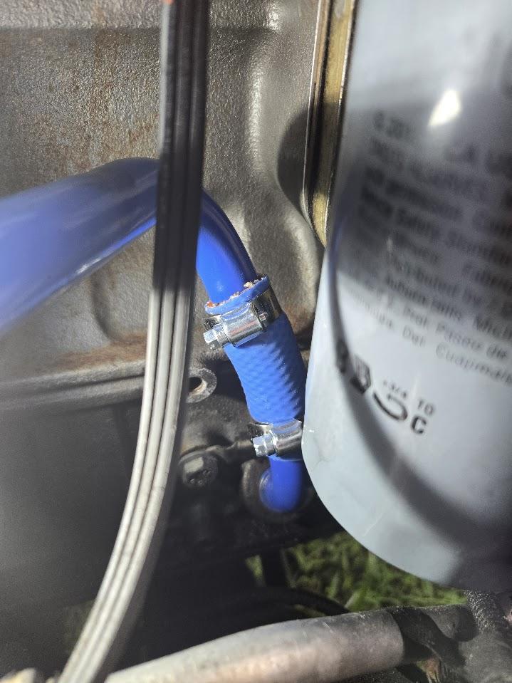

    Heater hose will work for the drain to block connection.

Disconnect the compressor discharge plumbing from the turbo and inspect for an oily mess. Then, disconnect the exhaust band on the exhaust side and inspect for the same.

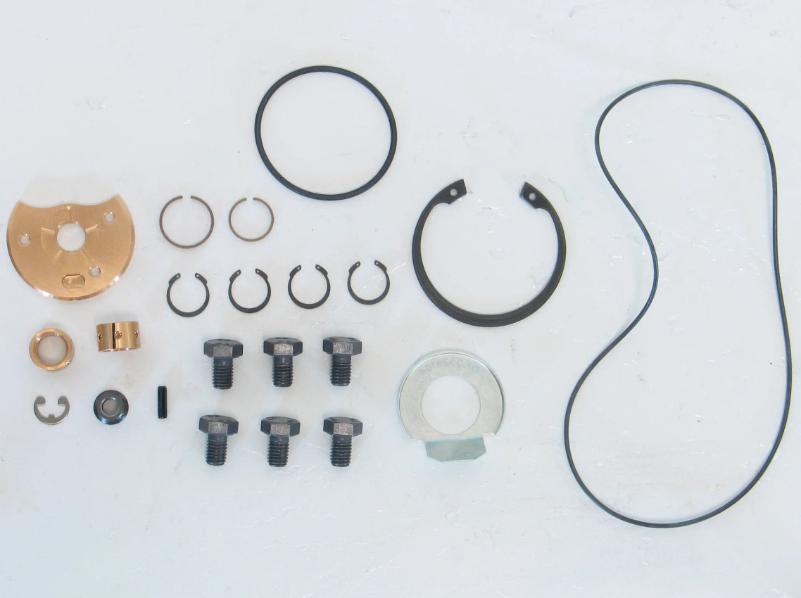

You could have rebuilt that turbo for cheap.
Diesel Auto Power
No image preview
Holset Genuine Rebuild Kit for HX35 and HX40 - 3575169
Check out the deal on Holset Genuine Rebuild Kit for HX35 and HX40 - 3575169 at Diesel Auto Power

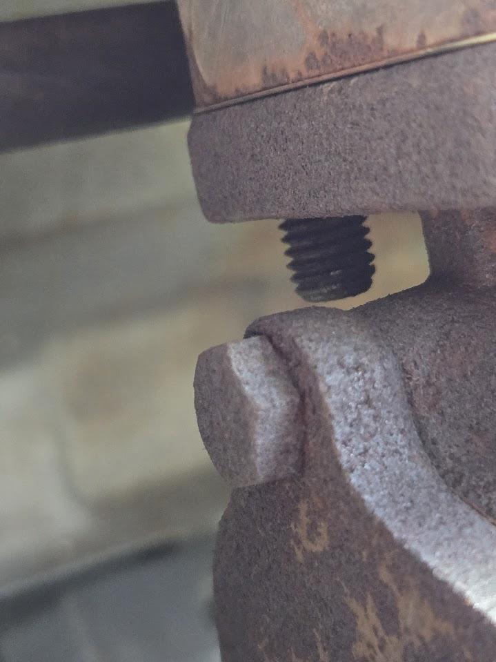

Oh yeah, grab a die and chase those studs, and then buy a few stainless steel nuts, at least they will not rust, and make sure to anti-seize those good!
is there a possibility the oil is going straight out the exhaust side of the turbo? I mean my main concern was that my oil loss was FROM the turbo(and could get worse)... otherwise my turbo is TIGHT...and I see no reason to replace it. I'm waiting on the new turbo to arrive (today) and will break the rest exhaust side down on Saturday to see if there is oil there. What size should the nuts be? If it is burning oil it would make me sad but that isn't my concern, DFC Diesel has already stated they will cover under warranty if that is the case.

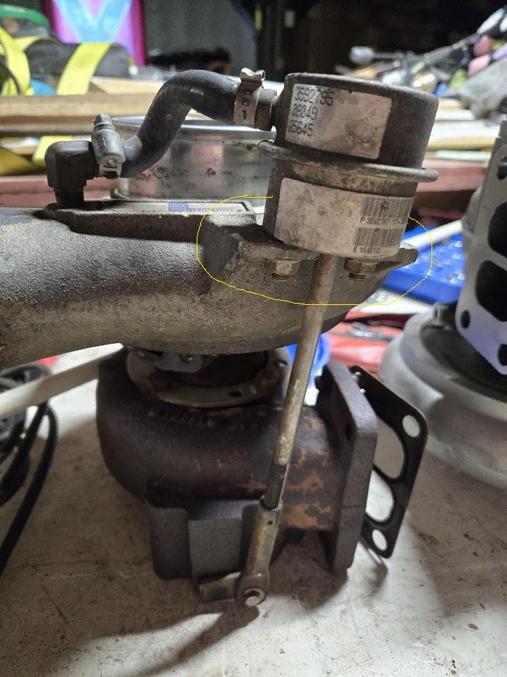

SO I just received the "reman" turbo... the geometry is all wrong... it came from A Premiere. I know you can adjust angles a bit... but literally the drain is on the "top" and the oil feed is on the "bottom" not sure you can turn them 180 degrees.
Turbine housing can be clocked by the four bolts and loosened, removed, and clocked correctly for your application. Then the compressor might have a large snap ring; you can release the compressor housing and clock accordingly.

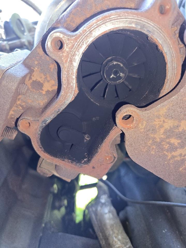

Ok... got the back of the turbo apart finally.... sooty but dry..I was REALLY hoping for wet... Is it possible that the oil is vaporizing due to the heat? SO do I replace it with the cheap chinese A-Preimere turbo($250) I have sitting here or do I send it back and later get a Rotomaster Reman ($550 w exchange) Here is a photo of the inside of the turbo.

That turbo looks fine.
I would pull the manifold off and check the exhaust ports for oil.

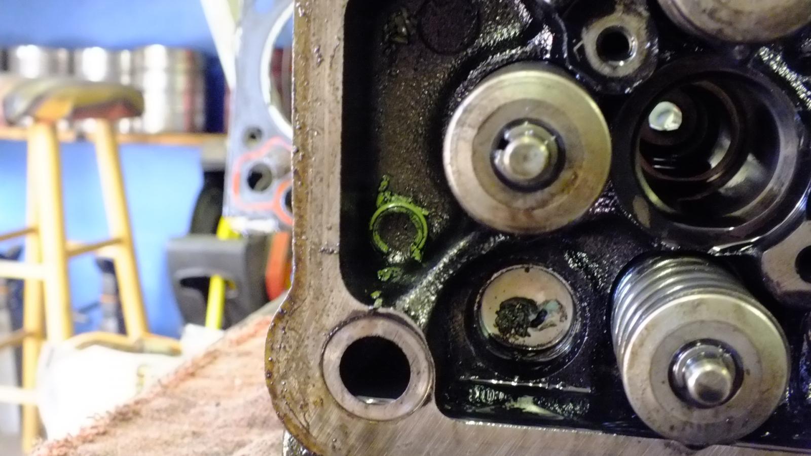

Some how you need to see the valve stems to see if oil is weeping past the valve seals.
350k on Beast
If valve guides are bad the valves will rock and eat the seals off the valve. This will allow oil in during idling and low boost conditions.
