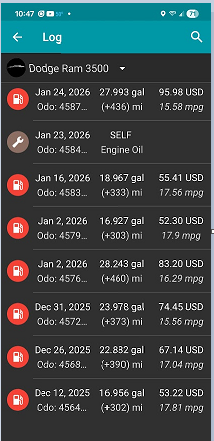

So.. if you haven't checked it out... do... Android and Apple... That being said, do the fuel lanes for semi's have DIFFERENT diesel than the auto lanes? I've been using the APP and filling up at the SEMI lanes but have lost about 3mpg when I do... SEMI lanes gets me 15 mpg and auto lanes get me 18ish MPG.... WHERE I get the fuel is the only difference..
Comments?

I get it... but also why I posted here... trying to make sense of the results I'm experiencing. The 17mpg fills ups were regular Auto lane diesel...
