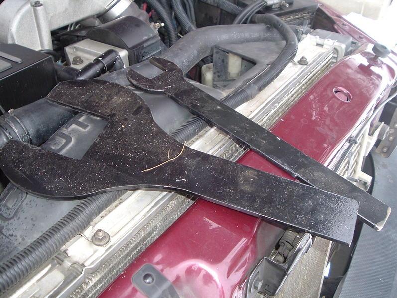

Ok guess I am just stupid. Repacing my radiator and got it out without having to remove the fan clutch.But tried and couldn't budge it. Searched this site and other places on how to remove it. Some places say there are holes in pulley mine does not. Tried using a rubber belt ratchet thing to hold pulley. Didn't work. Found this pic of tools to use but not sure what that 71 mm wrench holds. post-10242-138698173209_thumb.jpgThe 36 goes on nut holding fan clutch but where does 71 mm wrench go to ????Thanks Rob

The 71mm wrench goes on the fan pulley and the other one goes on the fun clutch... Hang on I'll go get mine from the shop and shop pics... post-2-138698173212_thumb.jpg Goes on the bolt heads of the pulley... Thanks to JL Welding I got a set of fan wrenches...:thumbup2:post-2-138698173218_thumb.jpg

Thanks everyone for the replies. I got the wrench set from oreilly's and it worked perfect. Thanks for the pic mopar it expalined the wrench on the pulley perfect. I kept lookin at my pulley thinkin there is no flat spot anywhere for that wrench to grab :lol:. When I saw the pic and got the wrench it made sense. Thanks everyone. I ordered the radiator onliine and it got here this morning. But the overflow spout got broke in shipping so will ship it back. aaaaaaaaaarrrrrrrrgh. Talked to the radiator shop here before I ordered on line I swear he told $310 when I called him. I thought oh well I am just going to have to bite the bullet cause i can't wait another 2 days and I call him back and now he tells me $190 $ 20 bucks cheaper than what I bought it online for:banghead:. Oh well. Will go get it this afternoon and then git er done.Thanks Rob
