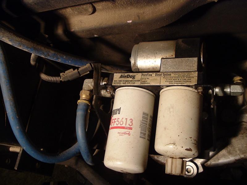

:drool:Have any spec on that Mopar Man. Need one like this.
That's mine exactly... Then the rest of the pump mounts on top of that... As for specs I guess I could do the dirty thing and pull mine down a sec to shoot pics of it... Geez... How I hate to pull the pump down its always a mess... :rolleyes:
Mike,I think the difference is your AD is mounted across the truck, not the side rail like the long bed... What is it mounted to?
thats pretty sweet Mike, does it interfer with the tcase at all? or driveline removal?
No... I've got just enough room between the AD150 and the transfer case to reach in and pull the plug to check my transfer case fluid. As for driveline nope its out of the way... It's back just enough that I got to pull the rear set of bolts on the skid plate to get the filters off the Airdog. But that's nice because all summer this truck rarely sees pavement...
Nice set up. Right angle bracket off the frame. I sure think it's better than outside the frame.
