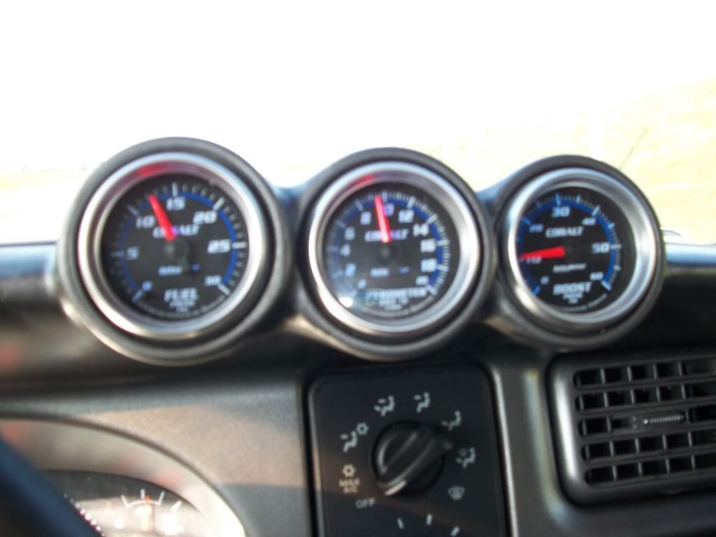

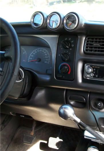

i was looking for someplace other that the a-post and the steering column when i dreamed up this setup.
Posted Image
Posted Image
Very slick! I like it... love to have one like it!
wow that is awesome!:drool: can you would you be up to making some more of those?
:smart:Bullett83 that is probably the most awesome piece I have seen in all my years of diesel forum whoring. It makes more sense and is more convienient and out of the way than the pillar mounts. You should get together with some production outfits and get more rolling out you could do pretty dang good on that idea.:drool:
:iagree: Wild & Free is right... I would jump on one of those if I could buy one... :drool:
i think it would be pretty expensive to start making these. it's actually the factory dash bezel that i modified. that would be a pretty big mold. the materials weren't all that expensive to make this, it was just a lot of time to fiberglass and blend it to look nice. but thanks guys, this was the first thing i modified on my truck when i bought it. since then, i've made a new shifter and knob, and a version of a twin ram intake.
well dang:banghead:!!! well if you dont mind sir i would like to have a friend of mine try and mimic this?
Sorry in advance for 100 questions. I see from your post, you used fiberglass... mat? cloth? putty? Did you use a form(s)? How are the guages held in? It doesn't appear to have access or at least not much access from the rear. I've had my dash bezel out recenly so I know that part pretty much snaps out with care.
i ordered a piece of plastic round stock and turned the pods out at work on the CNC lathe. then i used a product called Kitty Hair for stucture to hold them together and into the dash bezel. finished it off with some plastic epoxy repair. the gauges are simply hot glued into the pods, you are right about not much access from the rear. i used hot melt because if you want to get them out, you still can, hot glue isn't the strongest stuff out there.
