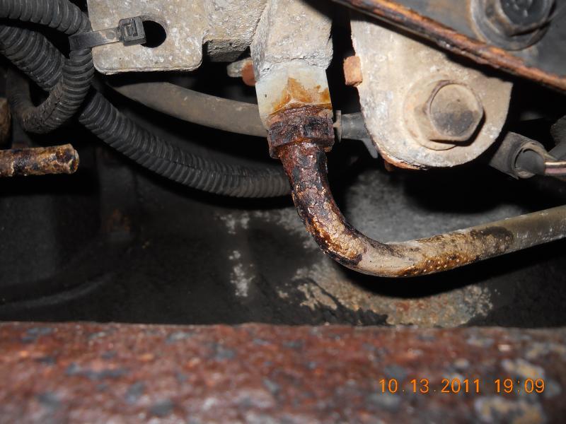

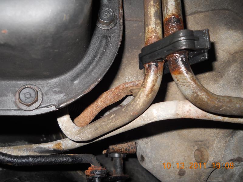

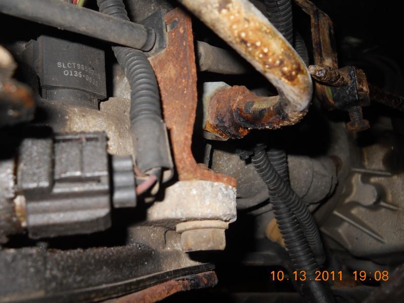

I have "leaky line syndrome" you know where the connectors hold the lines from rubbing each other along the transmission. They have started to rust and are beginning to drip. I called the Dodge dealer and the three lines cost $232.78 not including the little clips (rust starters) that are $3 each. The price didn't sound too hateful but I was wondering if there is another source that has lines with a port for the transmission temperature gauge that I am going to install?I called Geno's who sells them for the older trucks but not the 02. They recommended Goerend Transmissions who said they order them from Dodge and would have to charge shipping on top of that. No good.Any help from a "been there done that" guy is welcome.Also, are these lines a MitsuBitchy" to get off? After reading the recent posts about the ball joint fiasco, I thought I had better prepare myself. It takes less time to have hemmoroid surgery than to remove ball joints from the sounds of it. I hope this isn't akin to that job.
