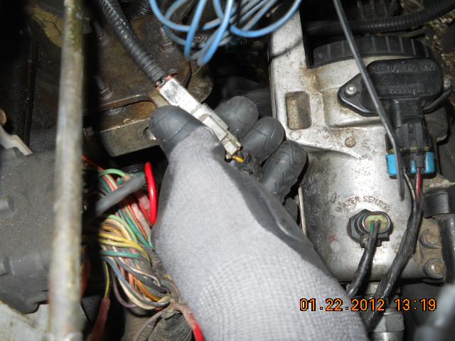

Welcome Jasvan, glad you came over. My AD's power also comes from the alternator to the AD relay. But another power source has to trip the realy. Thats what AH64ID is asking. My relay is fed from the alternator but the trigger comes from the oe wiring harness for the old lift pump. That harness is behind and below the fuel filter cannister. Check out the AD instructions, I believe they will show the harness and you can follow the wire from the relay to the source. Ill try and get you a picture of mine tomorrow.Is your FP gauge going to be in your hands soon? The fuel pressures would be very helpful and somewhat critical to diagnoseing the problem. The gauge would tell us whether you are connected to the ecm or an ignition source if you cant trace the wiring down.post-10340-138698184245_thumb.jpgI forgot i already have a picture. Dont let the photo confues you because my filter canister is unbolted from the engine and my hand is where it should be, but the wires you see are the oe harness and the AD harness connected.
I ordered it 2 or 3 days ago so it probally I hope by tuesday , the hook up two the airdog went down under the old fuel canister and too the center of the block ,I got my big self under the truck and the connector looks like its plugged into to where the old connector was plugged ,yes I am seeing now the importance of this gauge I wish I would of registerd on these sites long ago ,I wasent untill I bought a 2008 Super duty with the 6.4 that I started visiting the diesel sites with the issuse I HAD with it but it was under warrenty now it gone, 4.5 years of that was enough
