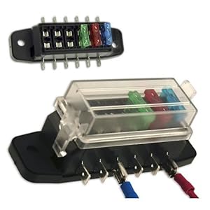

Posted Image

Indeed... That is a slick fuse block for exactly what you want to do. Just make sure you master bus line is capable of the total amount of AMPs in that fuse block. So if you got 5, 5, 10, 20 you need a cable capble of 40 amp load which I listed above.
^^^ That is a pass-through block. Meaning, that it's a one-in, one-out fused circuit design.It allows you to bus-bar a few together (say, 3 of them for 12VDC constant), and the rest for 12VDC IGN (switched, if you will).But as Long-hair stated, ensure your feed circuit is capable to support the desired fuse and amperage sizing chosen.

Posted Image
wheres this from - I searched ebay and amazon for terminal block - but only finding the non fused screw type :ahhh:

Found it
called a SIDE TERMINAL BLOCK in ebay
