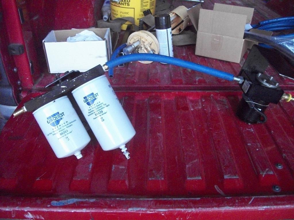

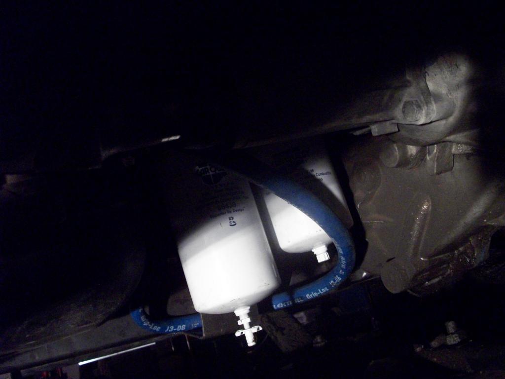

I have installed an aftermarket filter/water seperator when I installed a Raptor 100. I keep the stock filter, it not only has a fuel heater, has 'WIF' warning light, but also adds extra filtration. I put my on the drivers side inner frame rail just behind my transfer case. It was a tight fit with the pump and dual filters, but I made it work somehow.post-10349-13869819031_thumb.jpg I got the base while doing scrap metal, but they are CarQuest filters, so you should be able to locate them there or at another parts store. My filters are just above the skid plate for the transfer case so the are somewhat protected, I could make another skid plate, but I do not do very much off roading with my truck so I feel safe with the way it is. I am sure that if you go with one of the other options that you will be happy with it, just take your time with the placement of them and you should have no problems. Good luck.
Thanks for the ideas, I think that I am going to go with the vulcan set up and get rid of the factory setup of together. Its doesnt get that cold where I live, and I am sure that there is alot of guys that are running in colder climates with airdog and fass filter units straight to there vp with out any problems.

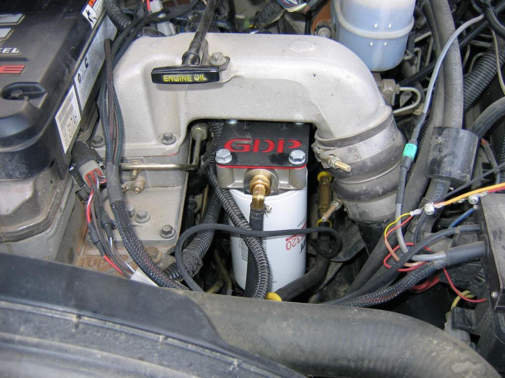

If the 2nd gens didn't have the APPS located where it is; y'all could plumb in GDP's 2 micron FF kit like on my 3rd gen..............under the intake horn and keep the OEM housing....................:2cents:
