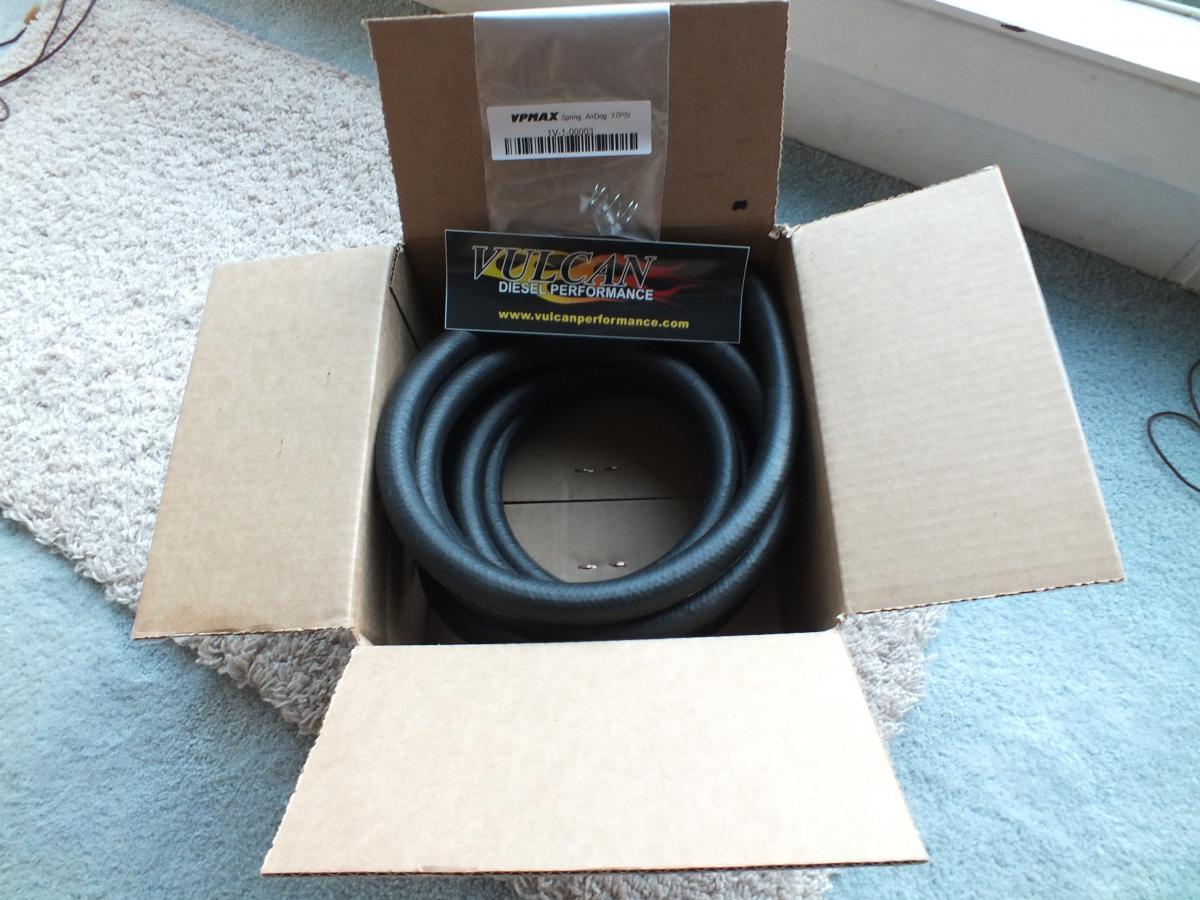

14 foot of Parker Super flex fuel hose is now here. Also ordered a 17 PSI AirDog spring. I'll know my fuel system will be up to snuff this weekend.
9 years is pretty good, considering the cost of that hose. Really good I guess, considering how many junk products are on the market these days.
My little box of goodies from Eric @ Vulcan Performance
