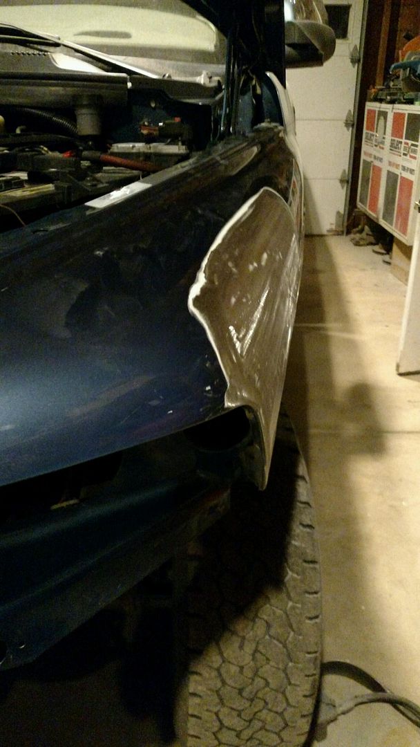

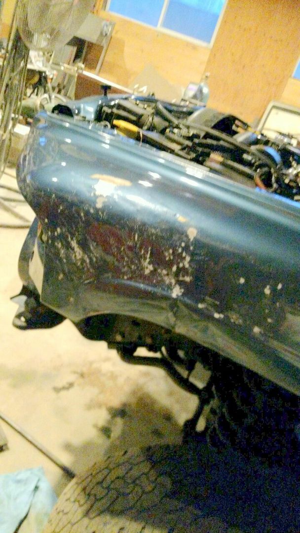

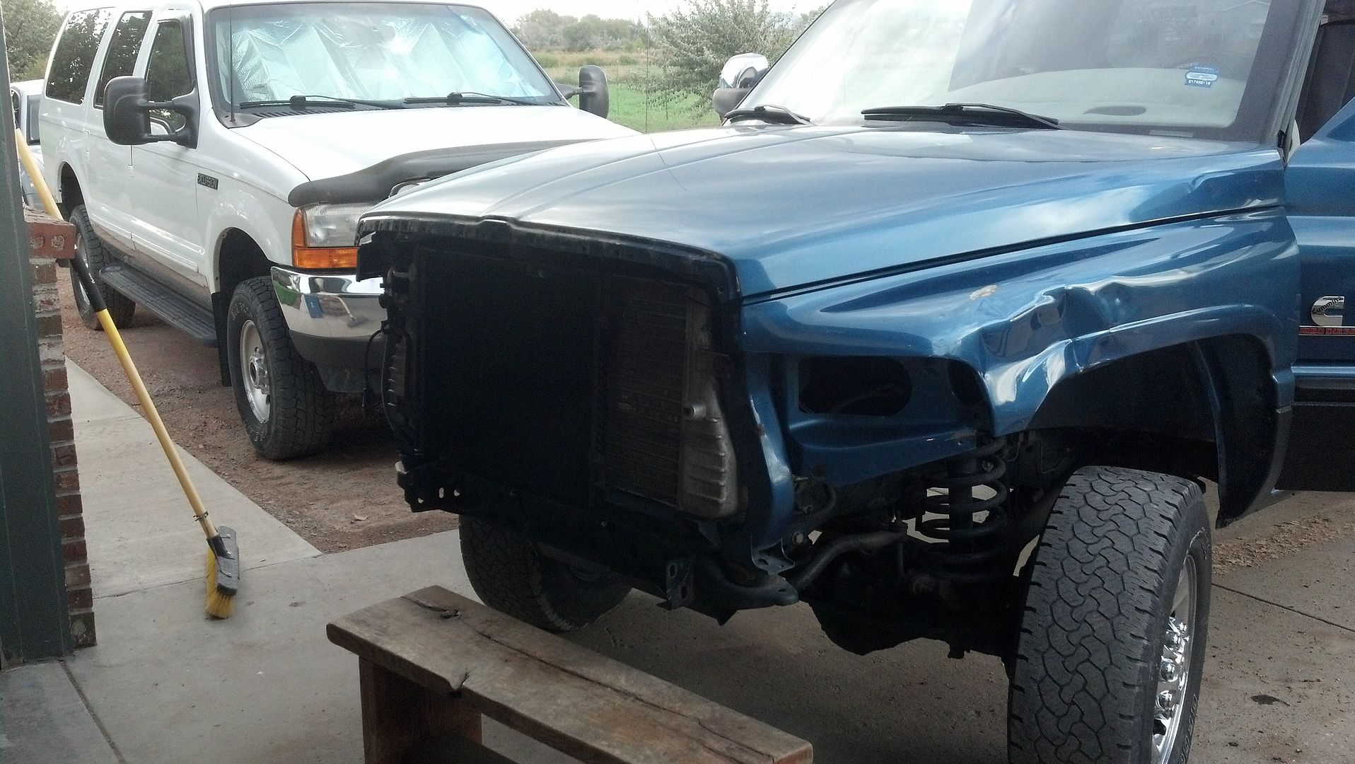

Me: No way this is getting fixed....
Body guy: Give me a couple hours and I'll get back to you
An hour later - Body guy: Give me another hour
Me: Idk I'm still skeptical....
BAM this guy works wonders! Hopefully finishing up the body line tonight.
23463-MMS-1444095857676-attachment1-IMG9
You don't find body men like that anymore.
Wow! Talk about patience and skills. So this bumper that's going on around Christmas, are you buying or building? I've been looking at a lot of bumpers but can't find one I really like.
