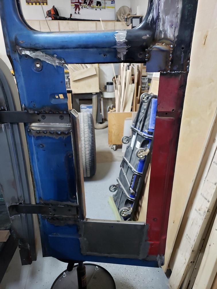

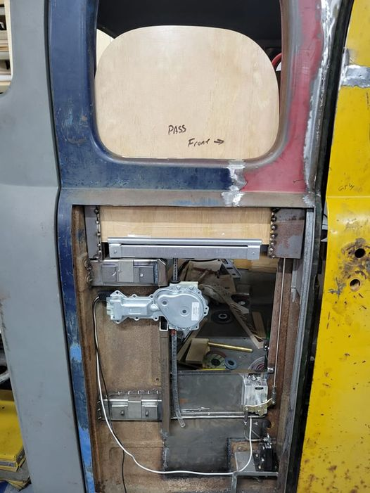

week's end work and weekend work: Finished passenger side door handle/bear claw actuation system Built and installed brackets to hold power lock actuators Modified the locking bear claw bits to lengthen them to pass behind the window track Modified brake pedal to allow for teh SC to live where it was Built and installed SC dash bracket/installed SC

Weekend's work: Modify the door linkage to use the inside handle where I want it and keep the sliding parts where they need to stay w/o hanging up. Also the bearclaw connector addition. 7766.mp4

Seats are actually out of an 03 Silverado (actually my buddies truck were were in a 65MPH accident in last year...got em cheap) And I'll refoam and recover them as well as replace the seatbelt bits. No rear seats...just a 1.5 cab not a 2x size. Truck will be a flatbed so I wanted storage for security/weather protection. As I said above, I will reskin the seats. Rest of the interior will be a mix of fabirc/carpet, likely some wood bits and metal surfaces. Not too far down that road yet...I don't want it to be an echo chamber with all hard surfaces. The bearclaw latches and suicide hinges are all sourced from "hot rod" sites/Summit Racing. Of course putting them all in DOES require custom work to be done. Regardless a pile of the stuff I'm doing is custom becuase no one else is likely as insane as I am to do this stuff unless they do it for a living.
