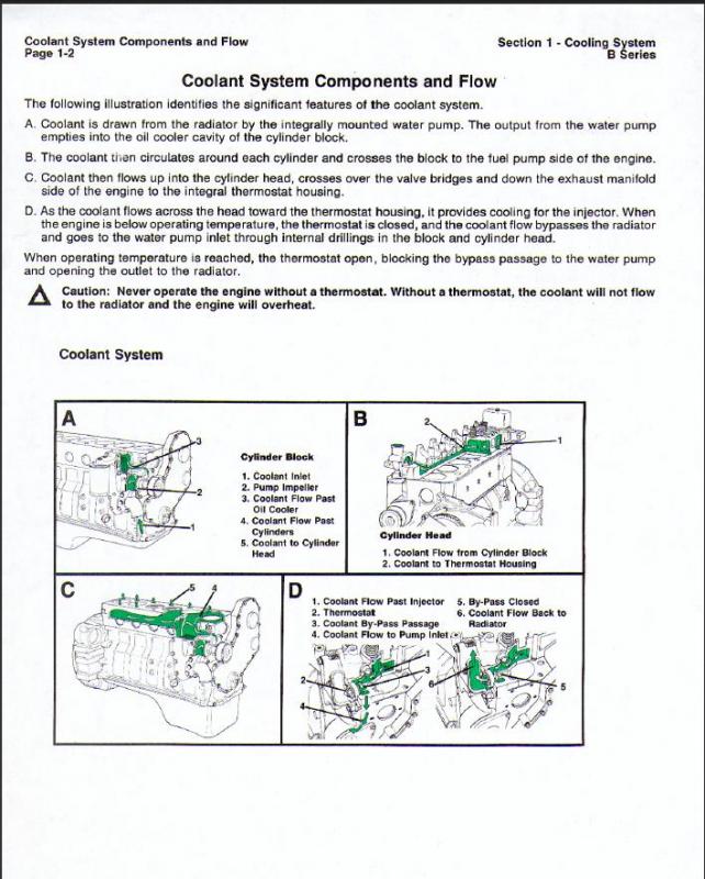

  2. My guess is that is was crap from new (something I read about more often with non-OEM thermostats). That photo is from the service manual I downloaded from the downloads section.

  4. I'm not talking about your external bypass, but the internal one. When the thermostat is closed the bypass takes the coolant from the head and feeds the water pump thru a passage. When the thermostat opens the thermostat will block that bypass and force the water pump to suck from the radiator, when thusly pulls coolant from the head. If the 5.9 V8 doesn't have the same internal casting it wont operate the radiator bypass properly. $30 vs 8$.. how much do you value your time? Even at minimum wage your time has exceeded $22 worth of labor. The symptoms you are describing are classic failed thermostat, high temp spikes and swings. I didn't realize it opened late, so weak may be the wrong term, so maybe slow is better.. My original tsat was very slow to react, big spikes, but it never dropped below 180*.
