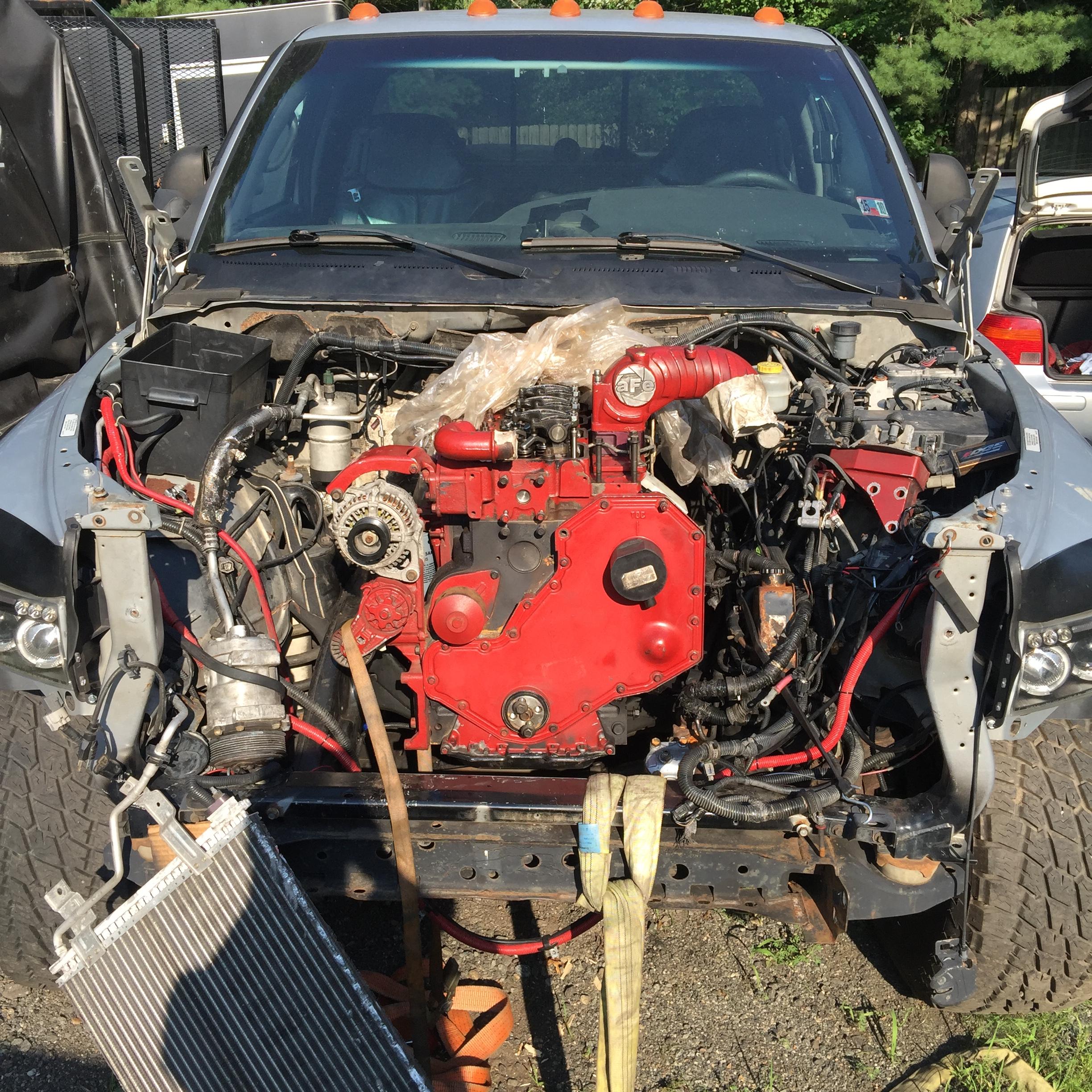

		For reference: G107 is ground I mentioned. Looks like I found the proper home using logic. Additionally; take note the proximity of CPS location versus where you are tugging...Seems to be quite close. This being said, are you absolutely sure you're getting fuel? The VP plug is right there too...I believe both of those could cause a crank no start condition. In what condition is your overflow valve on the VP44? After my truck sat for a while through the rebuild, the ball was happily nested in the seat causing a crank no start. I took it off, pushed in the ball, shot it with brake clean, started right up. Check it out.
