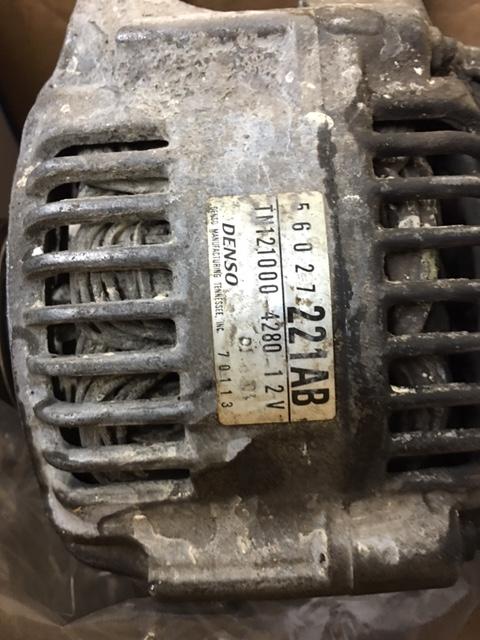

  15. You yourself say 0.1 is the limit in this article. Now you're saying 30% lower than that is too much? So what am I to do, order a half dozen alternators from every parts house in town, buy them all, install them, test them, and play a neverending round-robin game of alternator returns? I drove almost 80 miles the other day chasing down every alternator in the metro Orlando area. Only one of them came anywhere close to your numbers - and that's the one I bought. And it tests "OK" on the testing rig at the parts store that they use to approve/deny warranty, so what's your suggestion? Suck up the $130 alternator that's "OK" and go buy another one? Because they aren't going to take it back as failed unless it tests so, and there aren't any others available for a couple days... The truck started, twice, and cranked/cycled the fuel pump more than 10 times while I was priming the new VP44. It has cranked over every single time I've turned the key for the last 9 years and 170,000 miles. So to make sure I'm on the same page, the old, OEM alternator that measured 3.4VAC ripple allowed this to happen, and the new, remanufactured one that tests at 0.07VAC ripple is what's causing it not to (except when it does?) Or are you suggesting that the ECM is now somehow compromised? Forgive me if I'm slightly incredulous, but something does not add up to me.

  17. Alright, so riddle me this: I got everything buttoned up tonight, primed it (which is soooooo easy with the FASS) and it fired up and ran with less than 5 seconds of cranking. Drove it home from the shop (15 miles,) shut it down, let it sit for a minute, and restarted it. Hit on about the 4th turn of the starter and ran nice and smooth. Shut it back down and went inside to get a shower. Fast forward 30 minutes and I'm dressed for work and ready to head out. I get in, turn the key, and... nothing. Nothing from the starter, no dimming of the lights, no fuel pump... battery gauge shows plenty of voltage, but all I get with a key turn is a click from the starter relay. I swapped it with the blower relay just to see but there was no change. Oh and Mike: at idle the alternator I put on from Autozone reads 0.07VAC ripple.

  19. That's shocking. My NAPA didn't have one in stock for my truck (they don't have a tester, either) and it would have been two days to get one... I went to two Advance Auto Parts stores and both the alternators they had tested >1V. The only Autozone that had one fortunately tested at 0.4 and I went with it as a stopgap til I get my Mechman.
  20. Not impressed with the local rebuilders... none could tell me about the parts they install to build an overamp unit, just that it's $225 (oddly enough at all three places I called) and only one even has a one-year warranty. So, I read some more and wound up calling Mechman Alternators in TN, and they're building me a 170A alternator with nice parts inside for just $75 more, and a 2-year warranty. Should have it mid-October, he said they're pretty backed up right now. And in the meantime I'm gonna go to Advance Auto and buy a cheap reman and have them test til I find one that doesn't have excessive ripple...
