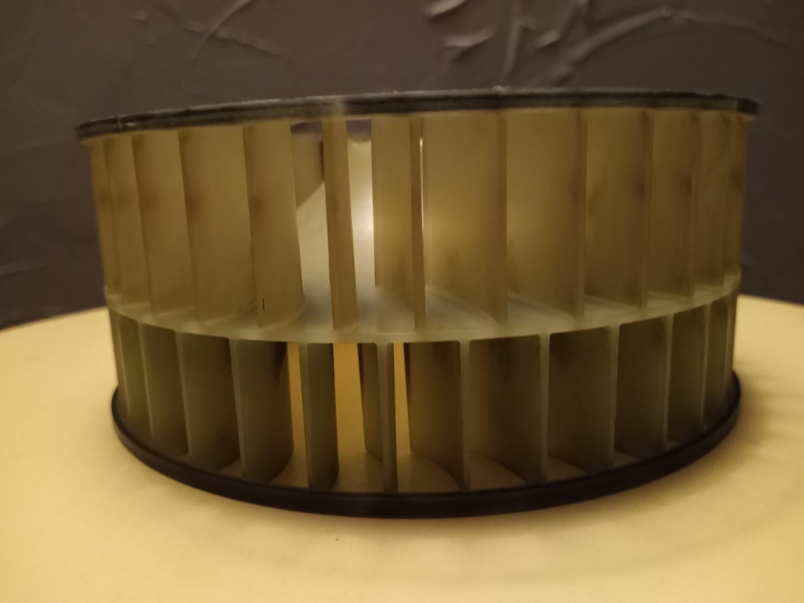

  19. To close the door behind the glovebox & recirculate the air is the way I have it now. The door behind glovebox is closed. It opens for recirculate & shuts off outside air from coming in. The Caravan fan is the easy way. JAG1, are you going to modify the door, or add a flap & cable or something to control it to open & close. Good luck. All I see is more cold air coming in. You will be on the wrong side of the fan. This is the first I have seen to try & help our heaters. It works exceptionally well for me the way I have it setup.
  20. He is correct^^^^^^ JAG1 If anything it would blow air backwards through them causing low air coming from heater vents only making things worse. Think of the fans working separately. The top half of the fan works as it should & the bottom fan draws air from inside cab compounding the air from the top fan being pushed into the cab. Remember, the cab is always under positive pressure when the fan is on. I do not have more air pressure, just a lot more air to flow, hence making it much warmer. Dieselfuture; Some had the cover, some did not. I think we all know how Dodge works from year to year.
  21. Simple, I changed the fan & bored 4 holes on motor housing. I did not touch original heater in any way, so it performs as prescribed. With the split fan, it recirculates full time because of the holes in fan housing. The top part of the fans does it's thing by bringing fresh air from outside, just like it should, & the bottom fan intakes the cab air via the 4 holes plus preventing the outside fresh air from coming in, with positive pressure going back into the airbox, thus full time recirculate on a smaller scale than MAX air. Look at the bottom of the the fan housing on the Caravan, it's wide open. Same on the Benz.
  22. No, because you are still mixing with the cold air coming in from outside. I poured about a quarter cup of water on the rug, & no fogging. Temp here has also been plus 5 to minus 20. Big temp swing but no fogging.
  23. The fan is off a 2000 Dodge Grand Caravan. I had to enlarge the opening for the fan to fit in the box by 1/16". Other than that is just to get the fan sitting right, (up down) on shaft. The other reference I used was a 2000 Mercedes Benz C200 blower fan. They feed a bit different way, but same concept. I like this fan but could not find one local, so the Caravan was easy access from a junkyard for $10.00 & the motor was from RockAuto at $12.00. The full time recirculate really helps a lot in keeping truck warmer. A lot of looking through RockAuto fans before I found the right one.
  24. Well this is what I finished with. 2 stage fan. The top fan is fed by the normal way & the bottom fan is fed by 4 - 7/8'' holes drilled in the base of the fan motor. You can see the bottom fan blades through the holes drilled at the motor base. The flow of air is far more powerful, than I had with the stock motor & blade. Plus is I now have recirculate on any switch setting. I can now drive around with the blower on floor only on low setting. Don't need center vent as it moves so much air it is actually to warm to need it. This is just what I was asking for, more heat, & I got it. Very happy. It's proven to work. Dodge wasn't the only one to use the setup. Mercedes Benz used this setup also.
