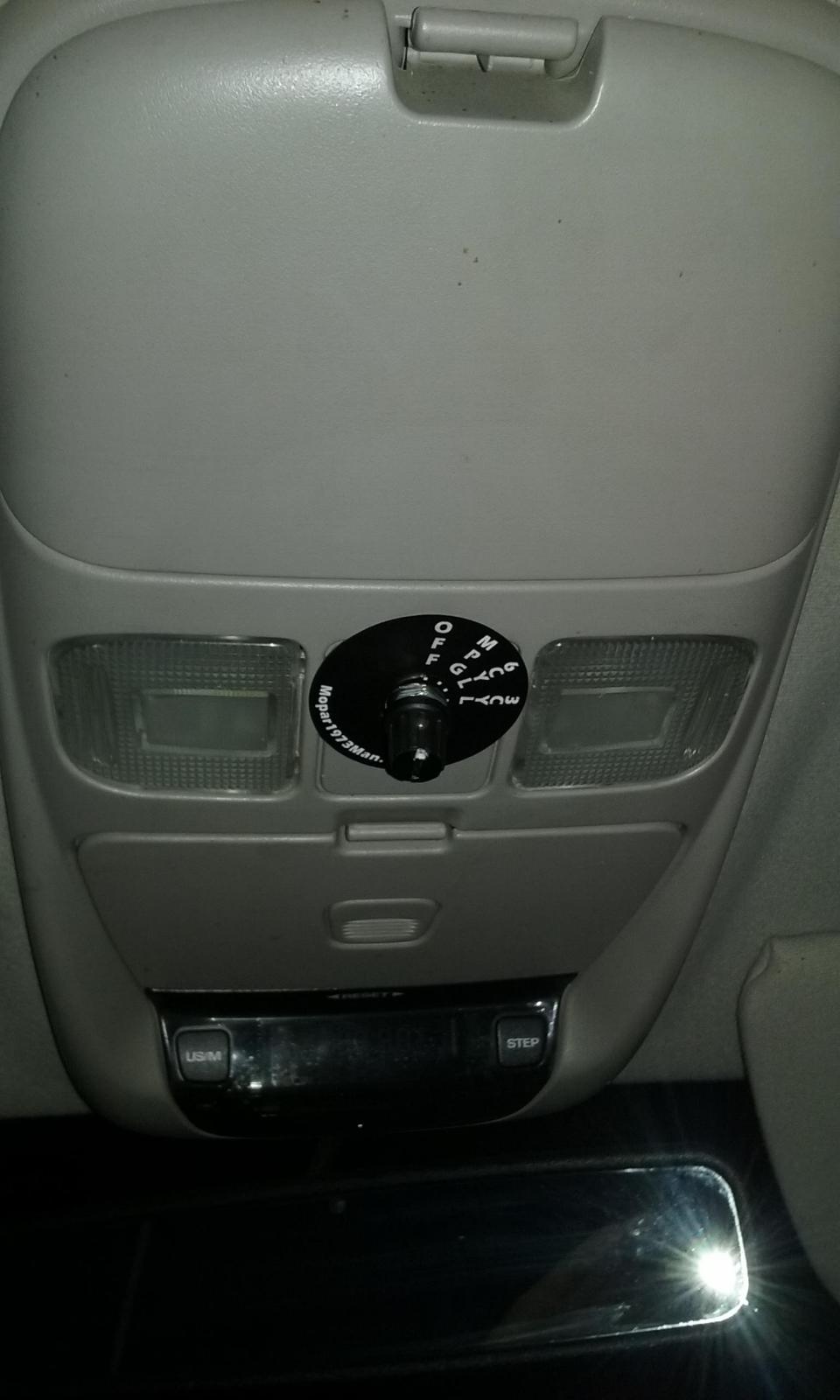

It's back doing the same issues plus it takes out my temp gauge if I'm driving in 6 cylinder mode also. I tried switching it to the 6 cylinder mode before I start the truck like Moparman said to do in a post which works sometimes. When it goes into the 3 cylinder mode instead of 6 cylinder mode then I've just let it run that way but would like it fixed.
If the truck is parked you can use 3 CYL or 6 CYL mode only.
If the truck is moving or being driven then you can use OFF or MPG mode only.
You cannot use 6 CYL or 3 CYL modes while the truck is moving. 6 CYL mode fools the coolant temp really low so the high idle can start. Which it cannot start because the speed is above 0 MPH and TPS is above an idle. Using either one of these modes will degrade MPG numbers.
  • Like 2
I am move them willing to test your switch for you, but I would ensure you aren't trying to drive the truck in high idle mode.
The coolant gauge will go to the bottom if it is in 6 cyl high mode, that is how the switch is designed, without that the switch could not do prolonged high idle mode.
