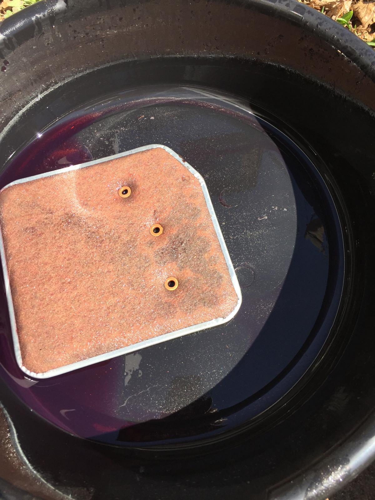

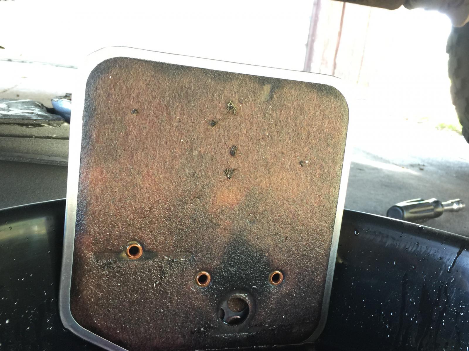

This is very true. I really wish I could go after this guy for knowingly building a bad transmission and then rigging it to make it work and now he won't answer me at all so now I'm out $4000 and a transmission.....
He also couldn't bother to tell me he put an older style valvebody on there so when I went to buy a transmission filter I bought one for a 2002, well those are too thick and won't let the pan on. I had to buy one from a 95
The valve body is not thicker, the pan is shallower on the early ones. Why he would have changed to an early shallow pan is beyond me... It makes me wonder just exactly what he built you!

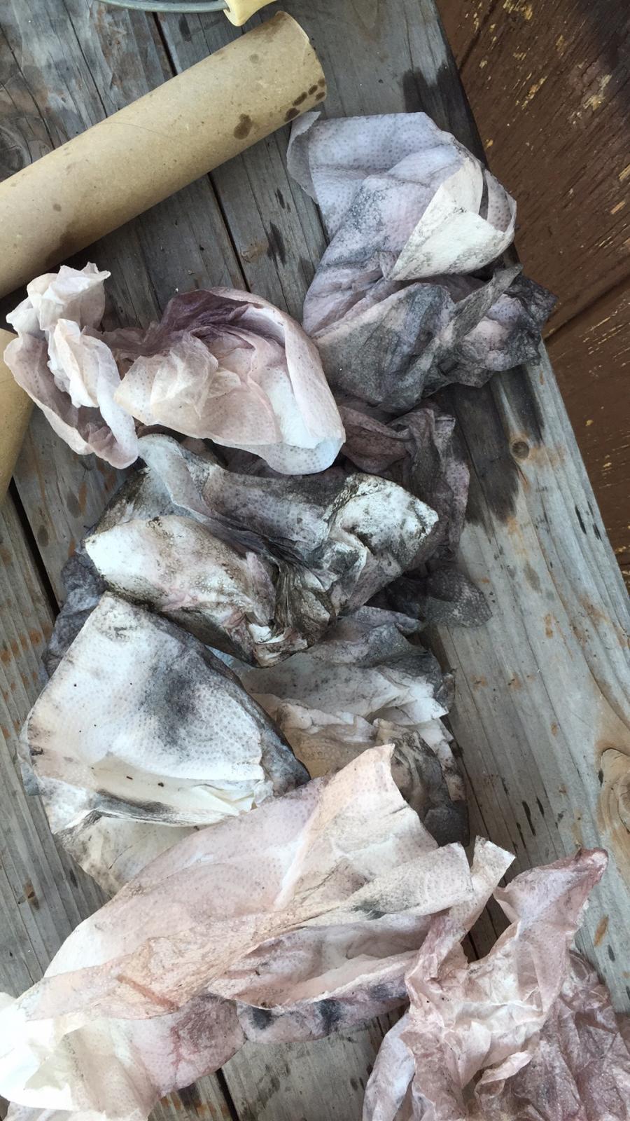

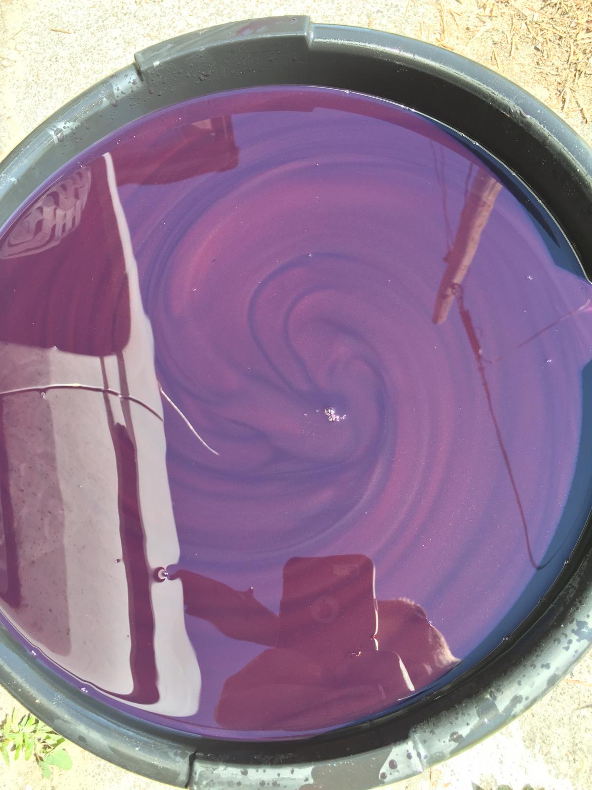

Something in there is definitely coming apart and making metal, and lots of it (duh...!). It sounds like it's slipping in several gears, and if you can put your finger between the servo pin and band lever after recently adjusting the band, your band (and likely your direct drum) is toast.
At this point, it is really going to need to come apart, including the valve body, to find where the metal is coming from, and why it failed.
