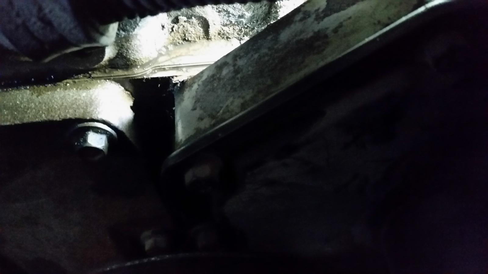

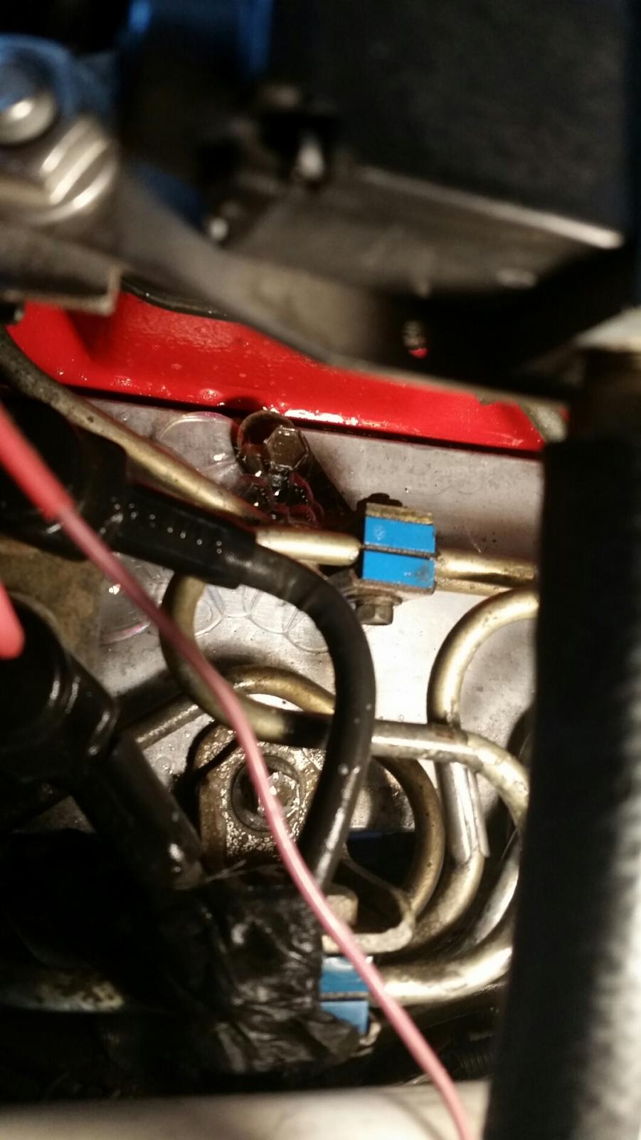

Well I hate to say that word head gasket, but I got oil bubbling out of front right, by head bolt just to the right looking from front( I got ARP's from po. ) It bubbles tiny little bit from head gasket and running down front cover, not enough to drip on the ground yet. Wondering where is a good place to get parts from, like a gasket set and whatever else I may need. Though about mabe going through the turbo but want to up size to at least a hybrid, so might just leave it be. Another thing is I already have ARP studs but not sure which ones, how do I tell, I know there is more than one choise. Will need to know torque on them when putting the hradon backnowledge on. Can I get the head off without removing studs looks pretty close. I will take the head to machine shop to surface and maybe even check for cracks, since I heard 24 valve heads like to crack sometimes. Will probably do a valve job and new seals at the same time. Not sure about ringing the head. The T at the back of the head, what's the best way going about it. Thanks for any advice. I will probably be lining up parts for a while and keep driving the truck,  unless it gets real bad or just blows out. I'm guessing there is an oil passage somewhere up front, just not sure how it's getting pushed out, oil pump pressure? Does it have something to do with coolant, I don't think I'm using any, maybe a little I had to put about a quart in the other day, will keep an eye on it.

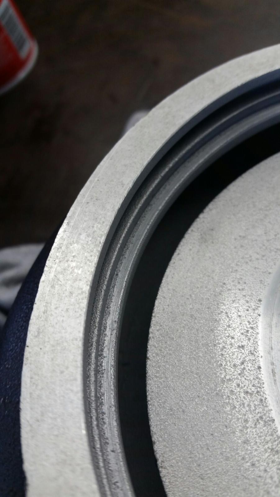

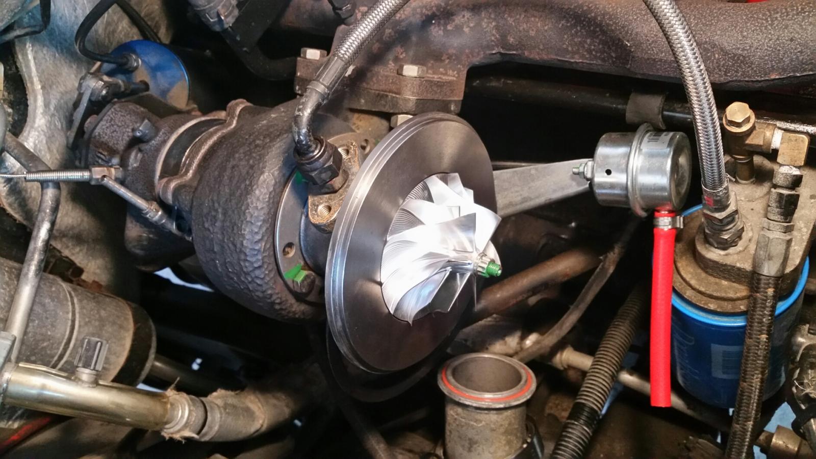

    Alright guys and gals, got my turbo today. I'm giving it 9 out of 10 and this is before driving the truck. Came with cnc machined beer opener. On first glance it looks good, on closer observation I've

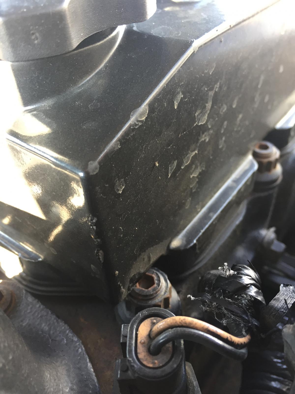

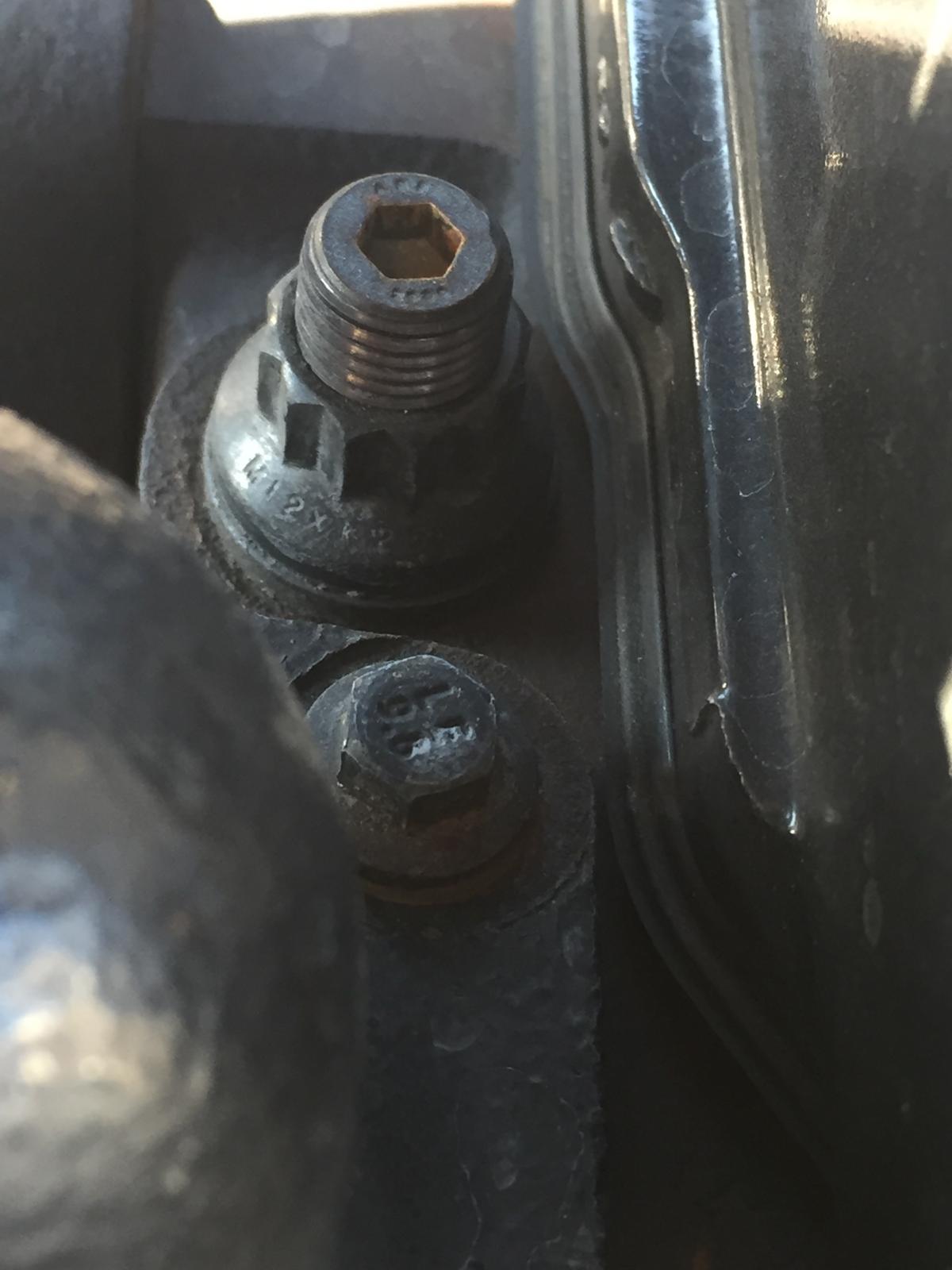

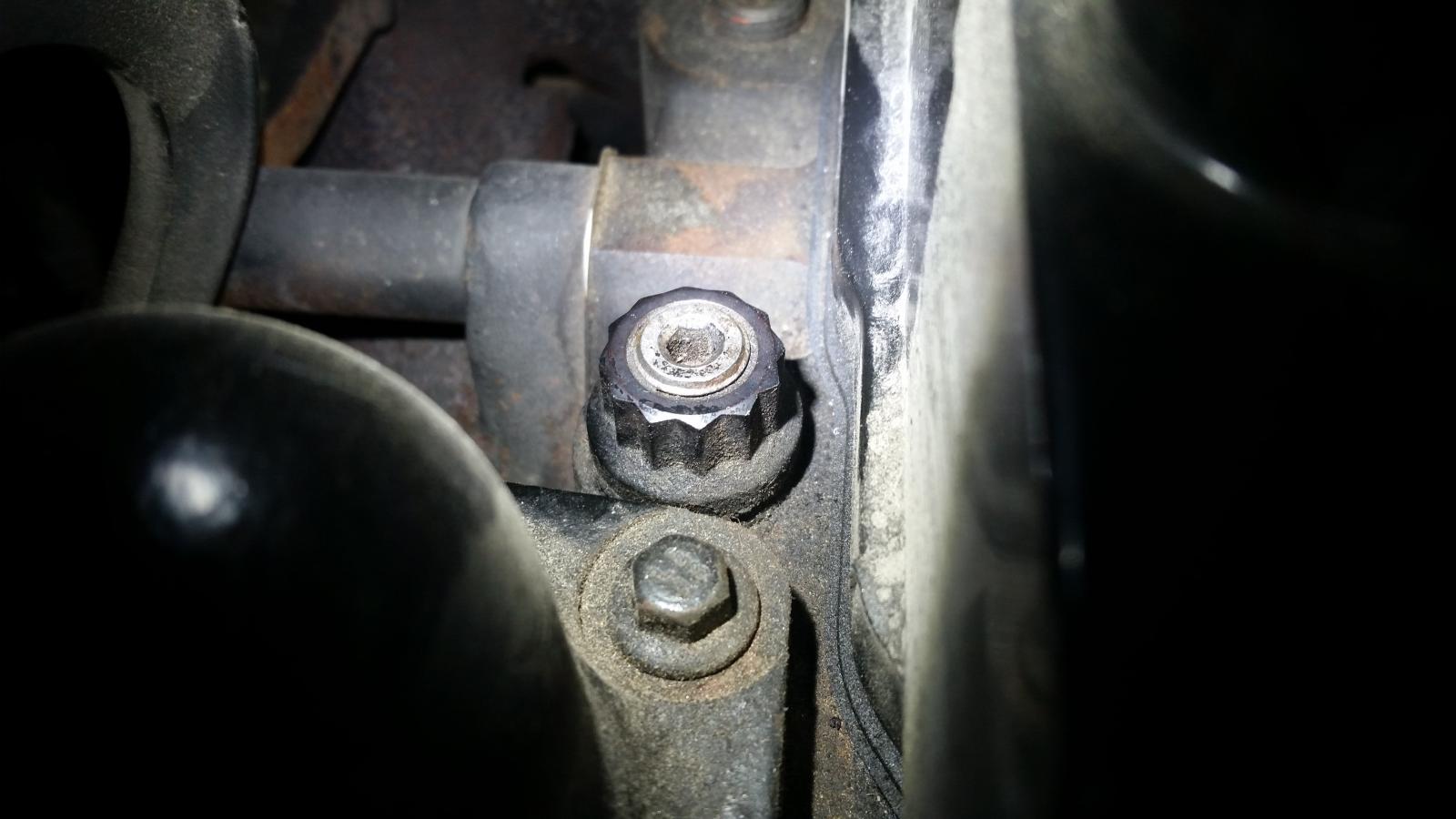

I cleaned top of the stud and it looks silver to me, what are the chances someone spend some serious bucks on this truck before, like maybe an oringed head too? And then when they sold it put old injectors and turbo in. Just guessing at this point, but here is a picture of a stud right behind tstat housing
I know there is a shadow on that nut but is it tightened down all the way? It looks a bit odd.

I agree with @jlbayes, something looks goofy with those studs. First picture is of the stud in the same location on my truck. The longer ones go on the exhaust manifold side, so I'm wondering if you don't have 6 longer ones hiding under the valve cover.
Second picture is of a shorter stud torqued to 135 ft-lbs. (I have ARP 2000's, the cheaper) Since I can't see the same amount of thread on your stud, I bet it's not torqued properly. Good thing the head is coming off!
And finally, I'm betting those are 625's. Torque on those is 150 ft.lbs.  No guarantee of the o-ringed head or previous high performance operation, as some people like to have the strongest possible to prevent issues.
