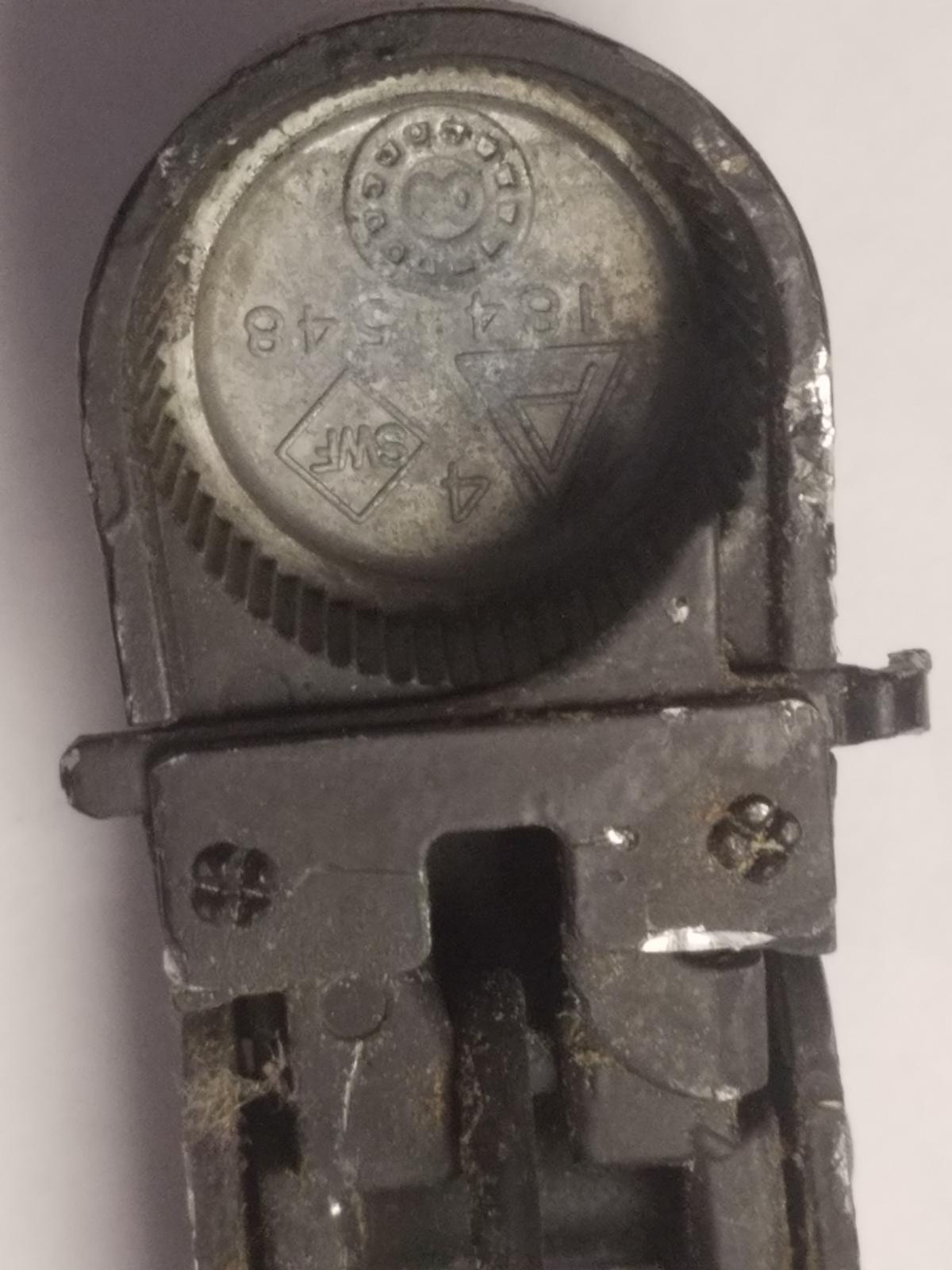

Wiper arms are easy to remove. Lift the arm up and you'll see a tab at the pivot. Lift this tab away from the pivot which unlocks the head. Now wiggle the head just a little and lift as you go. It will slide right of the splines.

Mine were not easy to remove.  First time removed since I got it in 2005.  Very stiff to pull tab up toward top of windshield.  You can see other end of tab at bottom of arm and see unpainted spot on tab after pulling.  My fingers to big, so I used plyiers.  Right arm that the pivot point is in center of windshield will provide couple yoga exercises for you.  Those little black plastic covers that have a torque head in them unscrew but not truly a threaded nut.  The warning in the manual about screwing it up (posted above) ...I'll find out today if i did.  And going to remove fluid tank and wash out good as something made it's way into nozzle and plugged it up.  Pic in manual not very good imo.  Here is pic that shows better imo.
