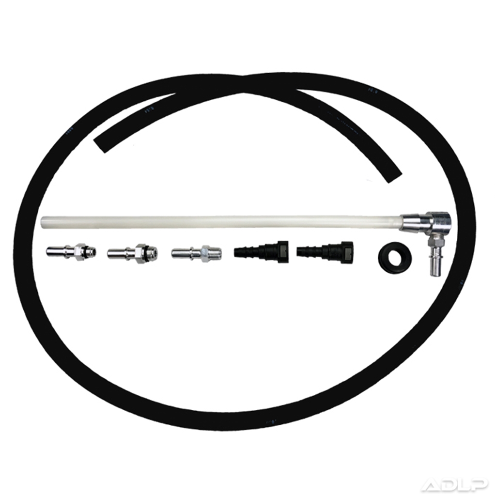

I guess I need a draw tube set up. I'm not that hip on the lift pump set up.
5 minutes ago, InGear said:
i'm pretty certain that my lift pump is drawing through an in tank pump. The pump is dead. The wire are plugged into it and I traced it up under the hood and they are bundled in two wire looms and ther is a red wire that splits and is plugged into a relay. I guess this is the fuel pump start relay.
You'll need to either install a draw straw... I would suggest a AirDog 150 or similar or mechanical pump.
Will I have to drop the tank to install the draw straw and is the airdog with the water separator and filter all in one housing the better set up? Could I remove the pump delete and the factory filter housing if I use that set up?
Don't delete the factory filter. KEEP IT! I run both 3 micron filter on the AirDog 150 but a 7 micron filter in the stock filter. I found out that even the 3 micron filter on the AirDog is passing dirt on to the stock filter and the 7 micron is catching.
Yes you have to drop the tank for installing the straw...

Look for  “Vulcan Performance Draw straw 5”. Vulcan is an advertiser on this site. It will replace in-tank pump. Either need to tilt bed or remove tank to install. If you look in articles section I believe there is an article with photos of the install.
Thanks Royal Squire. I Found the straw and pump for a good value. Should arrive to me next week so it gives me time to wrap my brain around the process of removing the tank and I can pump it down into some 5gal. containers as it is full.
Your old pump might pump it out. Worth a try. Or just tilt the bed up.
