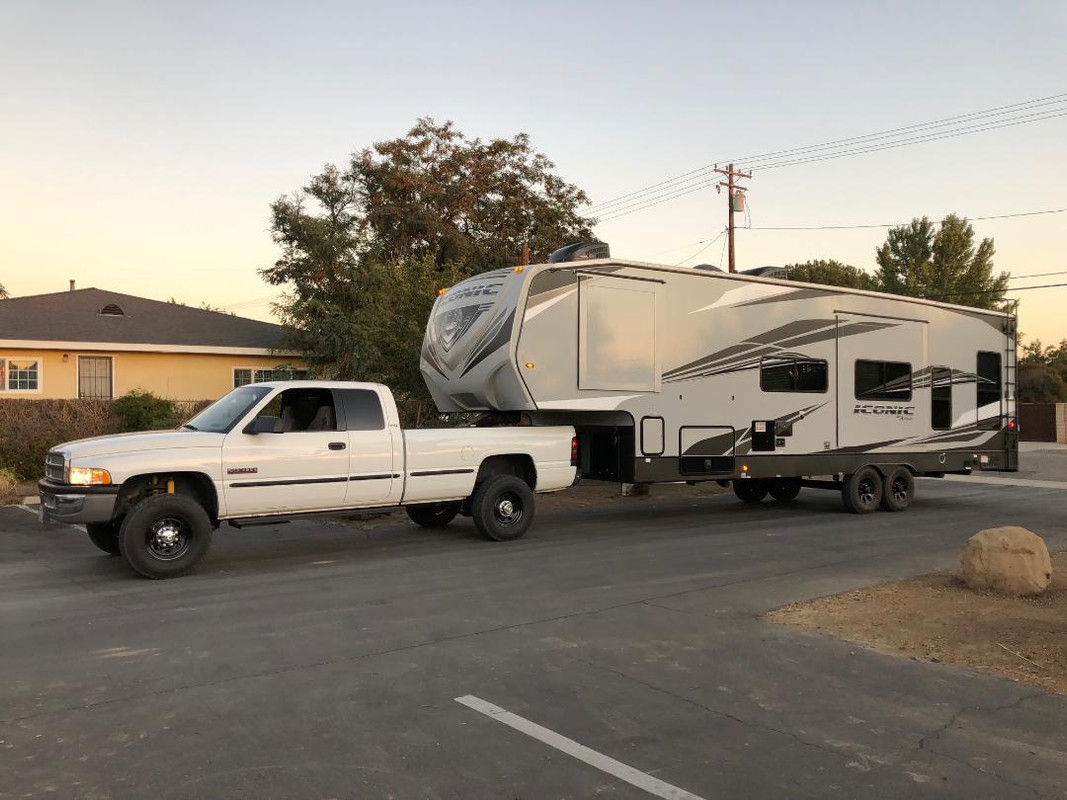

Quick update, i towed my loaded toybox (almost 14k lbs) 6.5 hours last weekend and absolutely no issues.
Turbo worked fantastic.. EGTs on the uphill climbs never over 1100 on quad level 3 with my 7x0085's.  I was seeing around 25 psi boost.  This makes me think i can go up to 7x10s which will give me closer to 35 psi on level 3 hopefully resulting in even more power with minimal rise in EGT.
I really cant complian... truck towed the load fantastic.  I maintained 65mph on the flats and never less than 50-55 up the grades.

Gotta love the white Dodges with black wheels!
