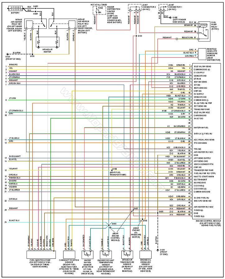

The graph shows the temp going to -40°F; that's an indication that there is either an open circuit or bad sensor.  Test the wires from the coolant sensor to the ECM and the coolant sensor by itself.   Be sure to test/check where all the ground are spliced together (see diagram below).
IBMobile how would you test at the splice? You’re talking about the S165 right? That’s the one in from of the ECM just behind the injection pump?

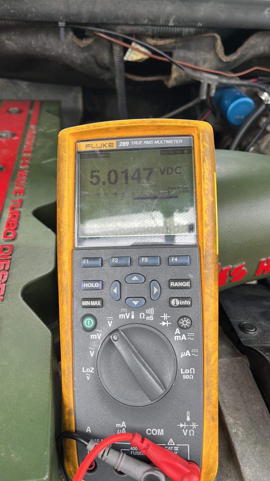

It has 5V constant at the tan/black wire at the ECT sensor plug. 1BB2EB8E-1442-4DE2-92BF-4B90A112D379.jpeg.403a9e5625551c8768fa40d735bbbe75.jpeg

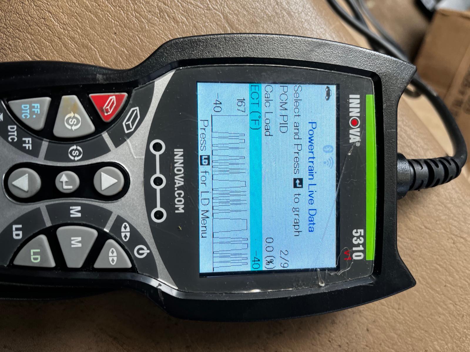

 Here’s a live view of the ECT and surging.
The Calculated Load also jumps.  Causation or correlation I have no idea.  The video starts with the ECT at -40 and the engine is at 0% load, then jumps to 16 and even 20% later in the video.  As said a few months ago, that S165 needs to be checked.  It may just be that only the ECT sensor's wire is loose and the others are fine, etc.
