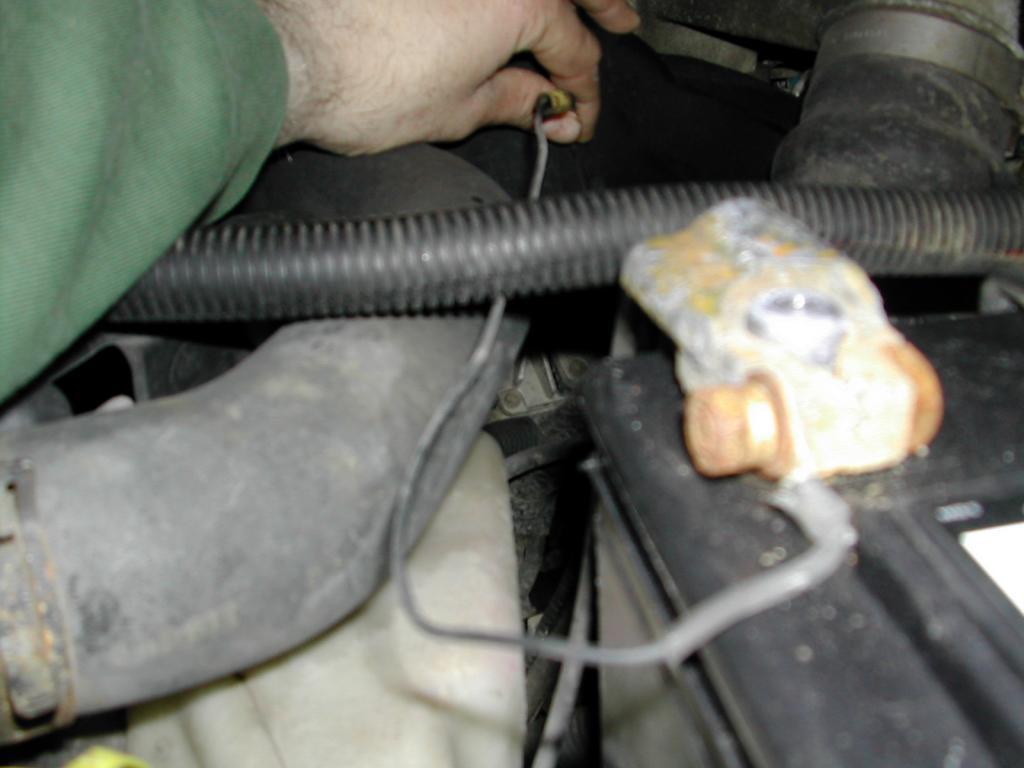

I hear your pain i was there last year it will cost you but a dealer may be able to re-flash the computer as to the shifting mine was a wire for the apps sensor that a local transmission shop I will go over to storage tonight and snap a picture of the wire... It goes straight to the battery.
IMHO that line will not last, my truck left me 200 miles from home the first time the second time I was close to the shop that built the trans, in short I broke three lines in six months costing between towing parts and labor a tick over 3k all covered thank someone for the warranty i payed for cuz it bought me my trans in headaches... BTW i went through steel, copper, then steel again. They put a big pump in with a HD tipple disk TC my suggestion to you which I did and I will post pictures, go and find a hydraulic fitting shop you need your factory fitting so they know what to get you and length (now I feel like a goon for not knowing what they are) they can use what ever you want but you want a soft line capable of 200 psi a company called hyquip did mine it will set you back bout 300 to do every cooler line.
- - - Updated - - -
My mistake you dont have an apps sensor if im corect but the first pic is the wire i was talking about. the second is the cooler with the coupler that you broke the two after that is drivers side going forward to the auxilary cooler/ and a partial of the crossover auxilary sorry I couldnt get good pics of the two lines that crossover the transmission or were they go into the tranny the third also shows the clamps we used to group two lines together available at any local hardware that weird white stuff is called snow :lol: had a few to much of that in the past days making taking the pics hard and you can see my high quality undercoating on my oil pan :thumb1:hope this helps you in some way :rolleyes:
