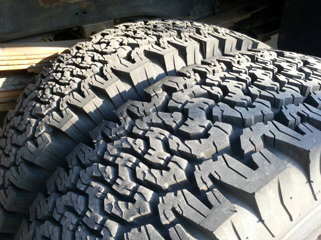

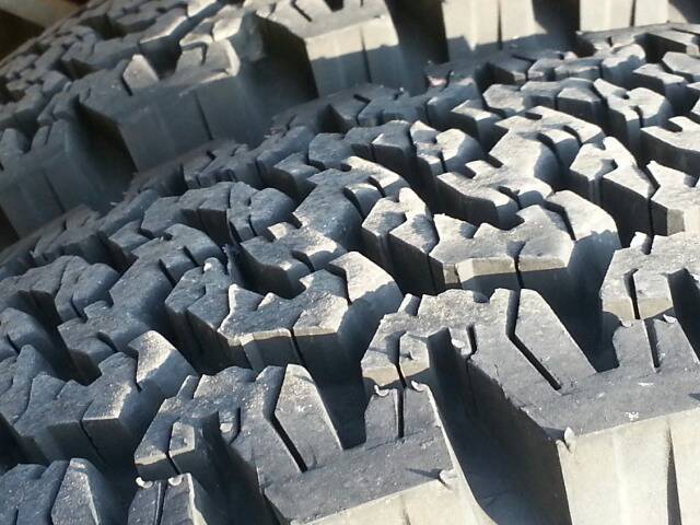

Just make sure theyre not building excessive heat at the lower pressures if your running loaded like that. Glad theyre working out for you, I'll be in the market for a set before winter and might take a closer look at a set of all seasons.
JR, I'm monitoring them with my IR temp gun. they're still a tad warmer on the center than the edges, but by about 10*F. I'm keeping an eye on them, for sure. with a rear weight (empty of under 3000lb, I can't see where 30-45psi would be a problem. Even my trailer loaded, I'm still at maybe 4000lb rear truck axle weight, at most. We'll see :)
I still must strenuously disagree with this method of tire pressure calculation. The logic is sound, but you cannot run a tire flat safely! By this logic, an empty trailer should have tires around 7-10psi. No!Many commercial tires will have a load table published suggesting inflation pressures for given loads. Follow those! If your tire doesn't have one published, look for similar tires and use them as a guideline. the very most critical thing in a dual tire setup is that the sidewalls do not contact each other. That'll build heat very quickly and lead to failure. Running such low pressures in your duals I hope they have a large amoun of clearance between the sidewalls to account for flex when you hit bumps or for the quick load you take while underinflated. Tapatalking in traffic

How are they holding up Rick? I have never been a dually owner and havent paid much attention to them but what Mindless is saying seems logical. Most any tire will have the weight ratings stamped on the casing for a single wheel and a dual and therecommended pressure doesnt change.
