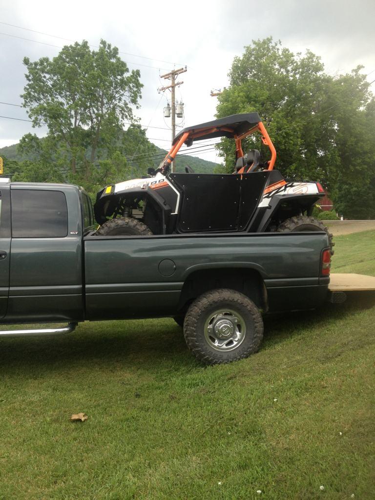

I've got a 2013 Rzr S LE , I'm thinking with fluids etc 1500lbs or less, I normally tow it behind my pickup on a 6x10 trailer. Heading down to Pocahontas for the 4th of July weekend ( which is approx 520 mile drive ) and wonder if it would be better to just put it in the back of my truck. Looking at safety issues as well as fuel economy. Truck is a 97 Dodge 2500 4x4 12 valve diesel with an 8 foot bed. It has helper springs and Timbrens. The truck... http://www.rzrforums.net/attachment.php?attachmentid=77849&d=1372129755

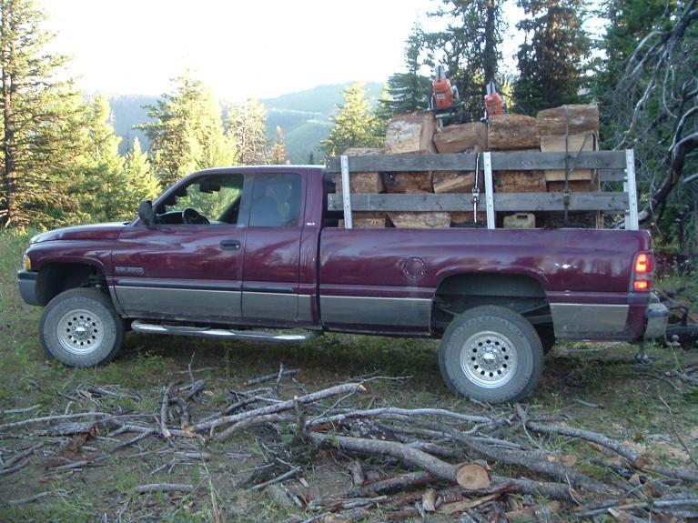

You'll be fine. As for the rear axle weight of the truck mine is 2,860 pounds curb weight right now. I've got a rear GAWR of 6,084 pounds which allows roughly 3,224 pounds I could carry over the rear axle. I haul my 700 pound ATV in the back of Mom's 1996 Dodge Ram 1500 without a thought about it.
I haul heavier loads in mine as a seasonal thing...
I know your toy is less weight than all this...:whistle:

Gotta put it in front to cab , wheel base is 77" so that's about 6.5ft which would put the heaviest part of the Rzr over the rear axle, so that should be good. My thoughts are hauling it in the back of the truck would save on fuel opposed to hauling it on a trailer ( wind resistance) ?

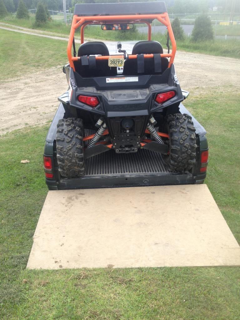

Hopefully you have a way of unloading it on flat ground, chances are you will have to once you get there. Are you talking about Hatfield McCoy? We were just down there in May. Good riding but I like the Rock House better.
Yep, HM. Trailered there last time, don't feel like pulling the trailer and after a test drive its like almost no weight in the bed. I'm after better fuel mileage and I think this will help. Plus none of the hassles associated with the trailer.

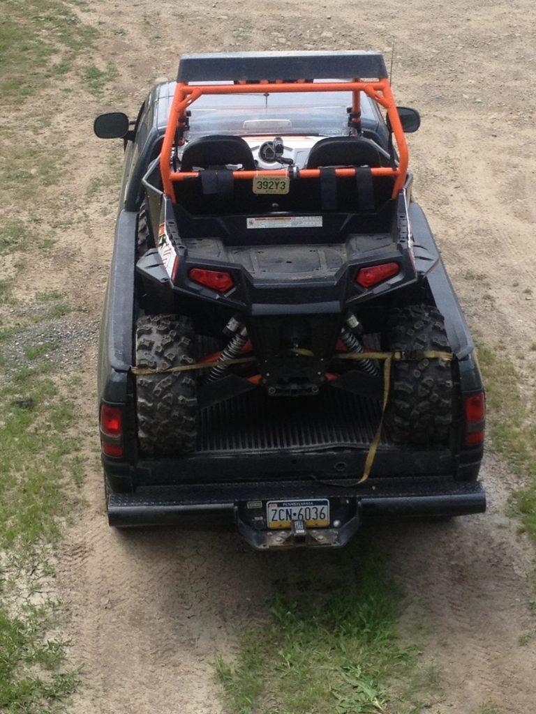

I strapped across the back of the Rzr thru the frame of the machine to the two most rearward stake pockets. Then strapped thru the frame in the front to the two tie down pockets in the bed. Seemed pretty stable and secure.

i don't like the way he has it strapped down. what would it do in an accadent? i load my Yamaha Rhino into my bed. make an X with the straps. from the front of RZR to rear pockets on the bed rails. then from rear of RZR to the front pockets. that keeps it from bumping the cab. no forward or rear movement. here in AZ, DPS will stop you and have you redo the tiedown.
The way the Rzr is strapped its not going anywhere . I only used the 2 straps for test drive purposes. I will have more straps on it next week when I make the trip. There was no front or rear movement , and definitely no side to side movement, with the dirt road I ran on as part of the test drive if it was gonna move it would have done it then.
