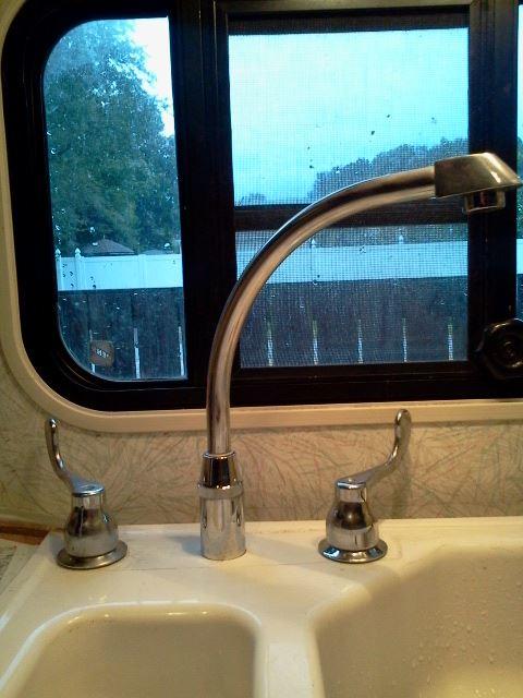

Out with the old crappy plastic faucet...post-1978-0-14449700-1409370579_thumb.jp And in with the new Brass base and Chrome finish :thumb1: post-1978-0-20060300-1409370580_thumb.jp

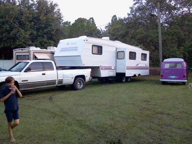

Thanks guys!! I did get it working before I left and it is still running and keeping the beer COLD!! I did have a blow out on the way to my destination that took out the fender skirt and ruffled some of the aluminum...post-1978-0-65131800-1409581192_thumb.jp I changed the tire and on the way I went and it gave me no more issues.  I do have to tear apart my generator and rebuild the carburetor however, it was running rich and making the muffler glow... (didn't see that during the day when I started it to make sure it still ran... haven't used it in several years, but it started right up and ran for 10 min on what little gas I had on hand) I just turned the throttle down a bit and shut the air off and all was good...post-1978-0-00680800-1409581065_thumb.jp
Time to look at the date code of the tires and replace any that are over 5 years old. Also did you check your air pressure before leaving? How fast where you traveling?
I knew they were a bit too old but yes, I checked the pressure before I left and I was only doing 45 max speed but when it blew maybe about 30 I had just pulled out of the grocery store ... (all back roads no highway) All but 1 of the 4 tires had great tread at least 58% depth left . The one that blew wasn't the one I had a question about... The one I thought would have had an issue did fine (about 35%) I knew I would be replacing all before my fall trip anyway :ashamed:  I will say the fridge ran well all weekend on LP though :thumb1:  And it did pull nicely even in strong winds :cool:
