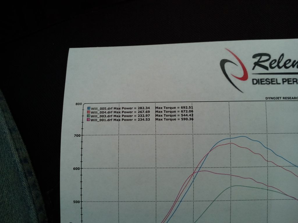

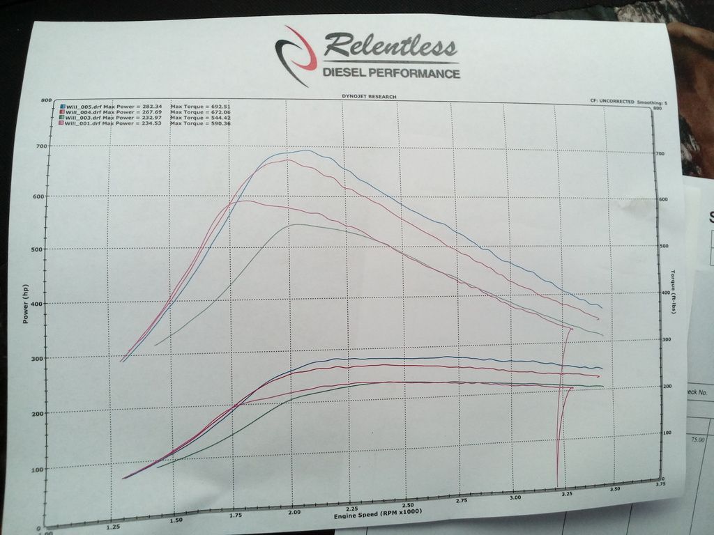

Got on the dyno today.
Made 282HP/692 ft/lbs torque. Still on stock injectors.
http://www.youtube.com/watch?v=xZrFICczbDY&t=218s
Run 1 (pink) was with the stock fuel pin. (O/D)
Run 3 (green) was stock pin, in 4th gear.
Run 4 (orange) was The Hungry Diesel pin. (O/D)
Run 5 (blue) was THD pin, and KSB on for more timing. (O/D) Did 282HP/692 ft/lbs.
I think it coulda done better with an 1/8" timing bump, IDK.
HX35 was gated to 35 PSI, and max RPM was 3,400. Hit 1,200* EGT for just a second.
Only fatality was the FSS. I also noticed some fuel in the AFC after those runs. doh.gif
I've heard nothing but good about the dyno at Relentless Diesel, so I feel confident in the numbers.
Edited by Texas CTD

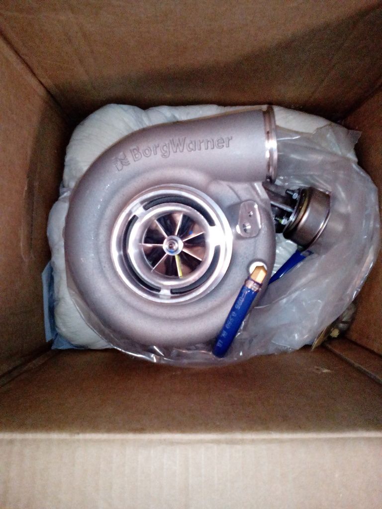

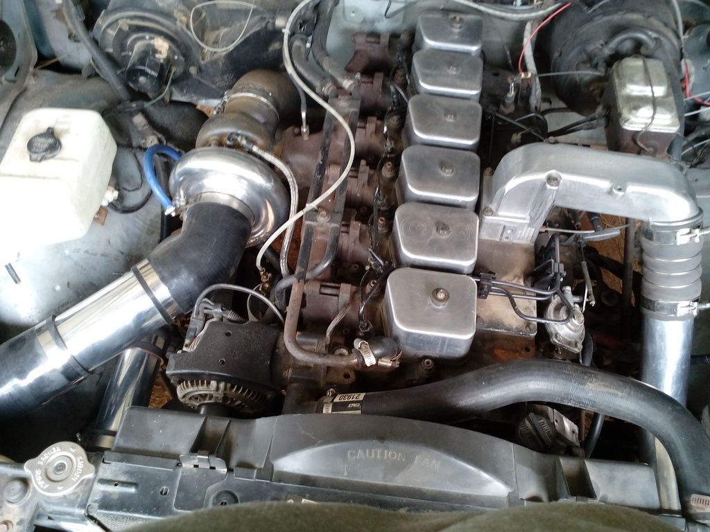

2 weeks ago I bought a BW S362/68/.70 SX-E, and I installed that last night. Things are coming together performance wise. I still need to add timing, and do lots of pump tuning, but it runs strong.
Pics and videos to come soon.
2 hours ago, TFaoro said:
Nice clean engine bay! Turbo specs?
Thanks, it's getting there. Still need to paint more parts, and clean up wiring.
62/68/.70 SX-E

It should sound nastier with more timing. I love that deep growl.
As it sits, it starts building boost at 1,600 RPM, and by 1,700 it's ready to takeoff.
And even though it's making boost, it's 2,000 RPM before I'm cleaning up smoke, and even then it hazes under heavy throttle. That's mostly due to the power screw being in as far as it can safely go. (which controls duration, so yeah, it's going to be dirty with lots of duration in my setup)
Like I said, lots of pump tuning still to do. I'm happy with the power, I'm just trying to get it to run cleaner.
After it's all dialed in, I'll hit the dyno. Goal is 400/800, but would like to get closer to the 450 HP mark. (which is hard to do with a VE truck)
