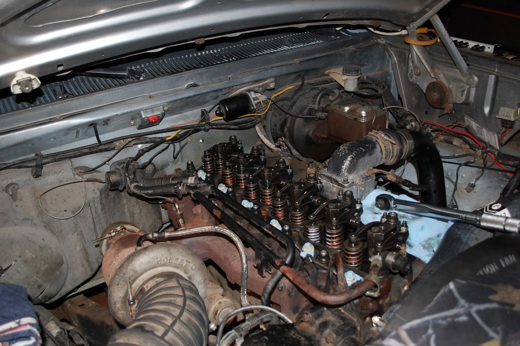

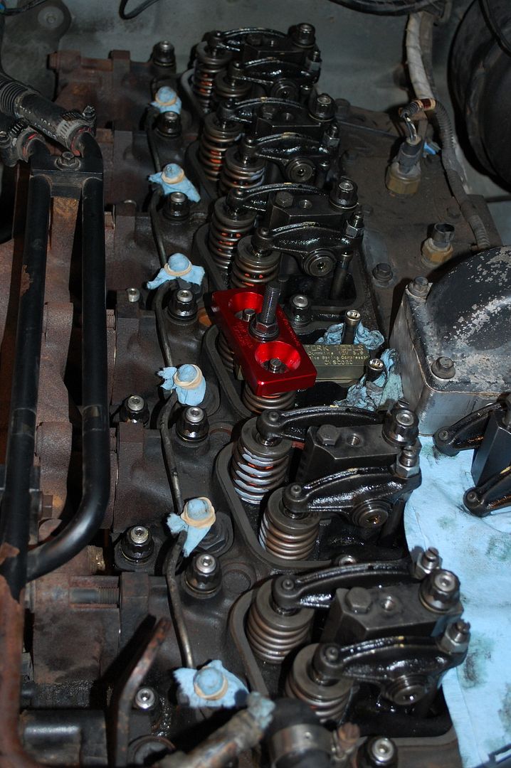

Truck now has head studs and +60lb valve springs... I'm doing this build backwards... Power first, then all the other stuff later. :doh:
The power bug bit me... I am going to try to build power the right way, and getting the necessary supporting mods done first.

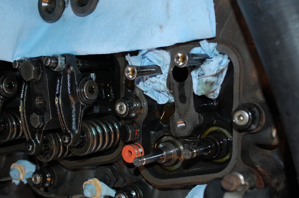

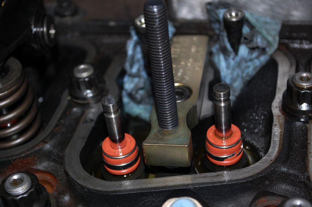

While I was changing valve springs, I also changed the valve seals while I was in there.
I took some pictures along the way.

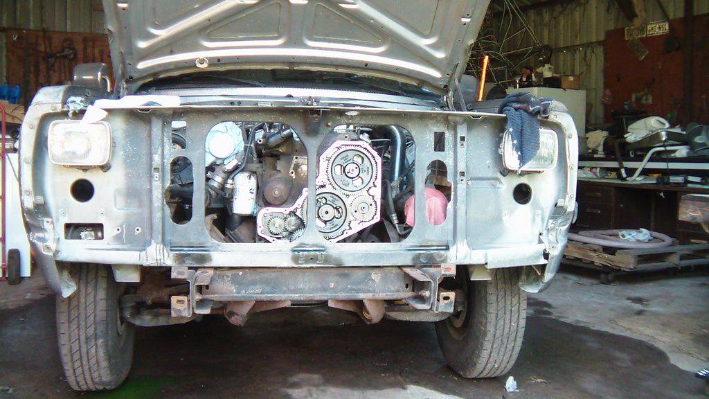

Truck dumped all it's coolant while on the way to work last week, and had to tow it home. Water inlet seal in the block was toast.
While waiting on a seal to show up, I'm doing some "stuff."
Changing the crank seal, and working on getting a powerstroke intercooler put in, with all new 3" plumbing from the turbo, to a 24V intake horn.
