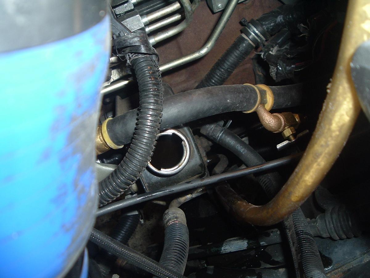

Anyone know why I would have my power steering fluid overflowing? All was fine for 3 weeks without driving it (Driveway statue) and then one hot day it's coming out the cap. With truck sitting idle for 3 weeks, suddenly the fluid is at the top and overflowing.

I think it's that the PS fluid was old, about 7 years, probably foamed up and then on the first hot day we had it sat there three weeks without moving BTW, it simply expanded in the resovior.

It was weird seeing that rather large area of oil, to suddenly show up like tha,t knowing I had not driven the truck for 3 weeks.
I going to do the return line disconnect instead of my usual turkey baister flush. Might be part of the problem mixing with the old fluid that a baister never gets out.
That is part of the problem. The pump only hold maybe a pint where the power steering gear box hold nearly a full quart to itself. Then you have the hydro boost with maybe another pint. So just pulling a few ounces out of the pump did nothing for the other quart and a half of fluid.
