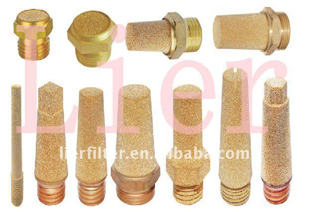

With any fuel pressure gauge you should never hook up at the VP44 inlet.
With all electric gauges they should be remote mounted away from VP44. Like mine I've got 5 feet of 1/8" air brake line to allow reduction of water hammer pulses. At the tap point I've got a needle valve and a snubber. Then 5 feet of tubing to the sensor.
Mechanical naturally have this long run after the tap point and also most are direct plumbed with a needle valve to dampen. Still in all I would use a ISSPro sintered stone snubber on my next mechanical gauge if I was to do it again. I'm very impressed with their snubbers. :thumbup2:
Sintered stone. Sounds like some gorilla grabbing clutch. I will have to google that one.
so that is what sintered is? My exhaust brake has a little "filter" like that on the vacum line IIRC. Just little pieces of metal mashed together. I am sure that is over simplifacation of the product
Correct I've got the same thing too on my exhaust brake vacuum valve.
