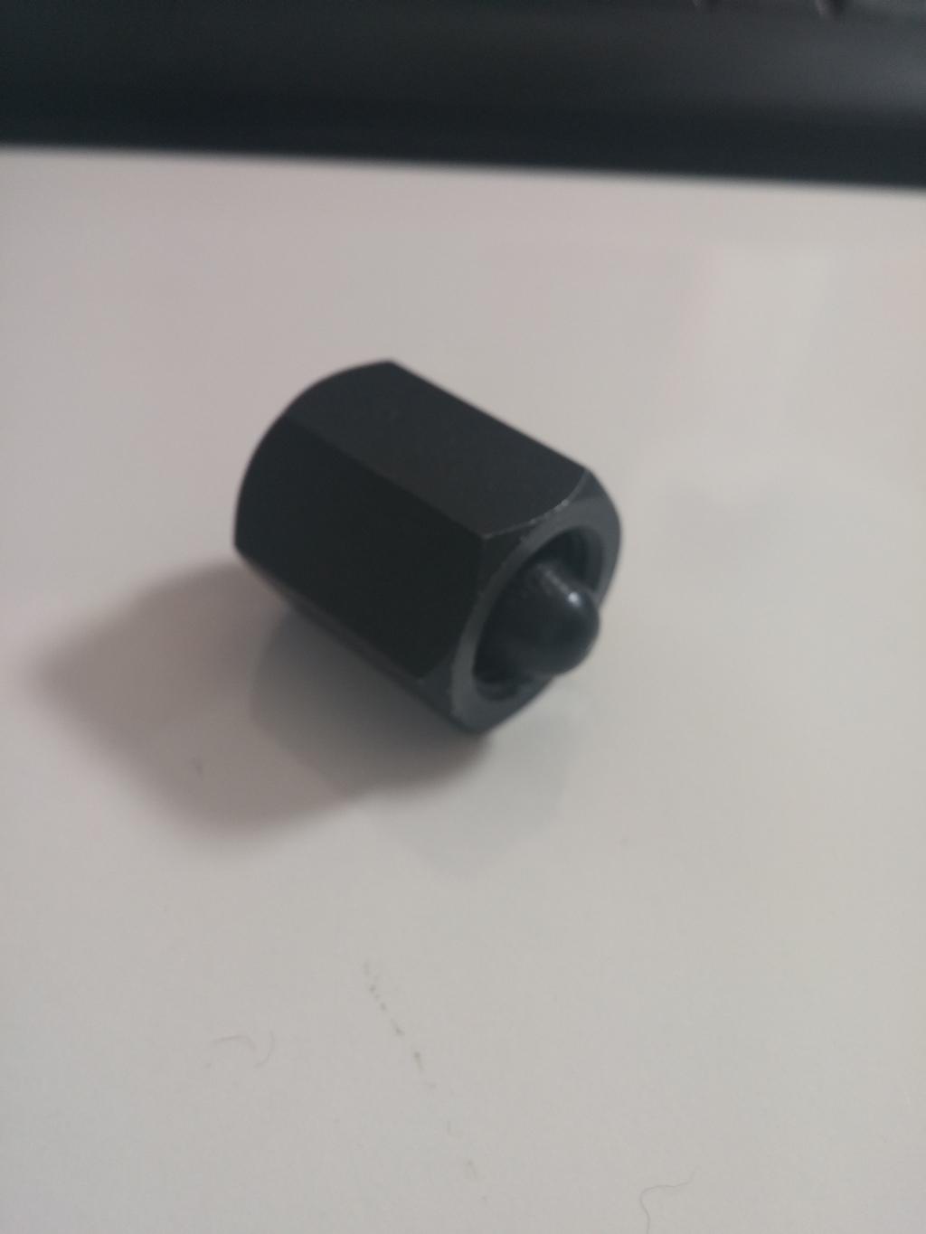

The problem is when the "A" hole (keep a clean mind guys) is damaged by fuel debris and no long seal properly so the injector tend to remain open anytime there is rail pressure. So the hard starting is because the solenoid valve is not closing allowing to build rail pressure.
There is other things like crack nozzle, pintle damage anything that would cause a fuel leak into the cylinder or high return flow rates to the tank from the injectors.
Most shops will use a block off cap to find the bad injector and replace just the one. I just happen to have a block off cap too.
