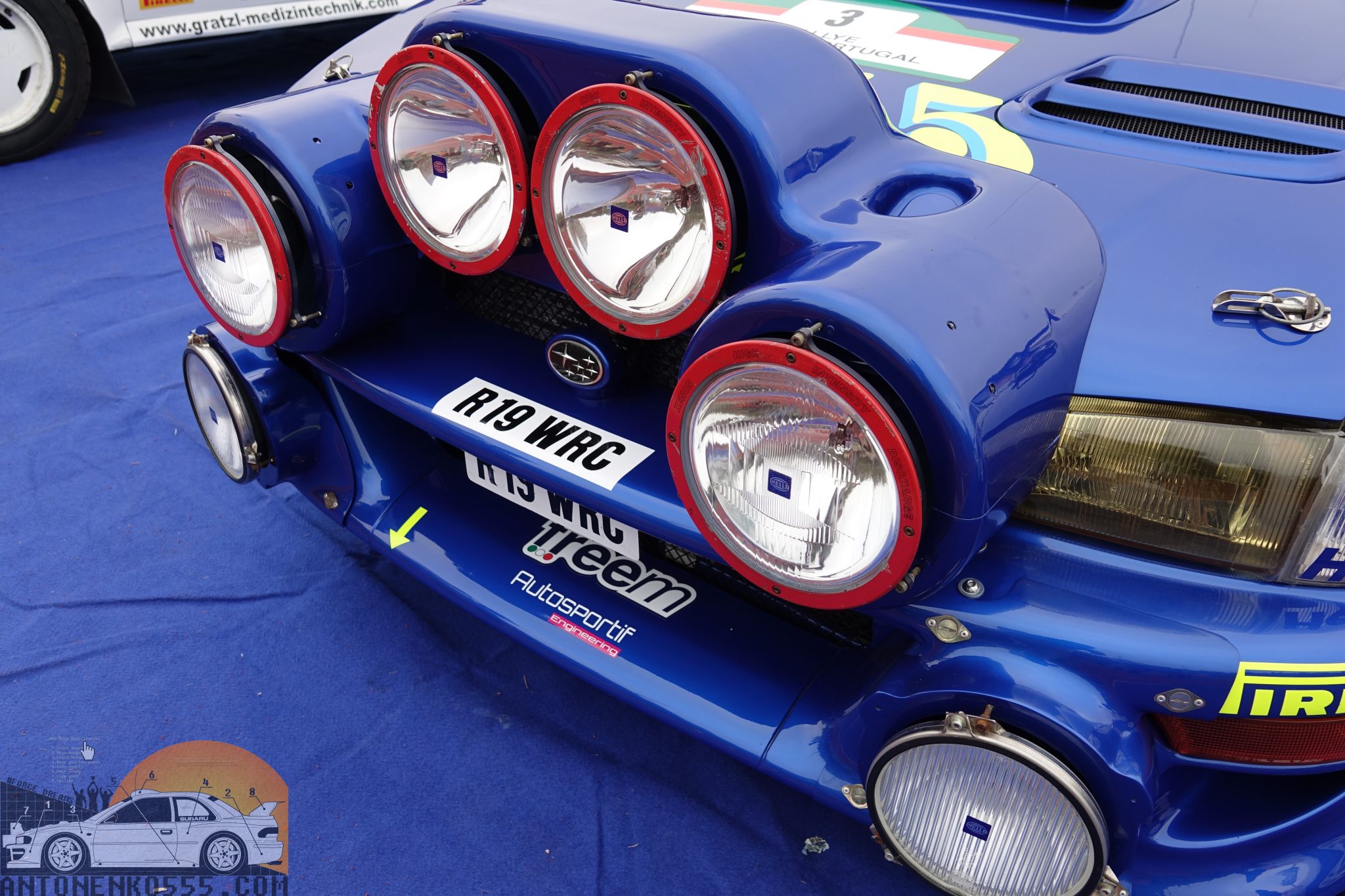

$1000 my be like:
IMG_3082.PNG.aee5e44bc7a4a98db5f0a57734c
or
