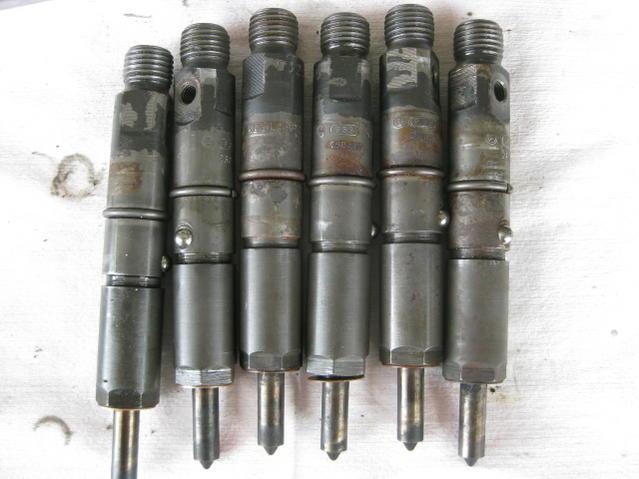

In the first picture the 1st, 3rd, 5th have heavy black chunks of some kind of oil or dirt.Thats what i was seeing.Just clean them after you remove the o rings.Then oil the new oring and roll them on.I use a old tooth brush.Be carefull not to scar them at all when cleaning.Dont run a screw driver up and down on the tube to clean them.
I cleaned them with that same tip of the knife that I used to pull the injector tubes out since it doesn't have any sharp edges and I also used diesel with a rag. thanks!
