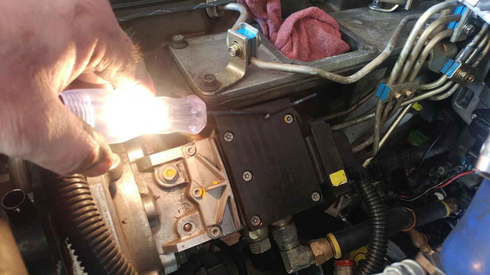

Ok here is the difference between the 10 year old plate and the new plate. The new plate has a nut to back up the jam nut on top. That was an issue with my old plate if I was to over tighten the jam nut it would pull the tap screw out of the plastic.
Now installing...
You need to remove the intake air horn and the APPS sensor to get enough access to the cover plate of the VP44
Using the supplied security TORX bit remove the 5 screws/bolts. Do take notice there is two types of security TORX screws there is the 5 point like what you see in my VP44. There is also the 6 point which some other rebuild have been known to use. Be aware of the type of screw. Now lift the aluminum cover off the pump. Now be careful and make sure the rubber seals are still on the VP44. there is one small rubber seal that came up on my plate stuck. Just make sure to put it back in place.
Now place your plate on top and re-install your 5 TORX bolts/screws again. Then start your tapping Alllen screw in the supplied hole. Grab a test light and hook it up to the negative post of the battery and turn your ignition key on. As you tightening the Allen tap screw watch for the test light to come on. Then according to BD Diesel you add another 1/2 turn I cut that down to 1/4 turn.
Make sure to turn the ignition key OFF before continuing. Now BD Diesel supplies the jam nut for the Allen. Assembly your tap wire with the supplied crimps. Note: Check your crimp on your tuner before installing the blade crimp. Mine was a slightly different style and had to be changed out. Place the Tap wire on the stud now. Carefully thread the nut on the stud and the hold the using a Allen wrench hold the placement of the tap screw while you tighten the nut firmly. Now turn your key on once more and test your tap point.
Now reassembly your APPS sensor and intake horn. Hook up your Quadzilla Tap lead and go for test drive.
At this point I was so excited to finally have my Quadzilla tapped into the VP44 again I didn't check my wire tap settings on my tunes. Needless to say as the Quadzilla release to tune mode and I laid on the throttle deep it rolled SERIOUSLY black cloud. Yeap it's working but once I pulled over and adjusted my tunes properly I got it down to just a faint haze. It pulled like a scalded ape now.  I'll upload my tunes here shortly.
For the first time in a year I had to turn ON the EGT limit and the boost limit again. I'm loving it... :burnout2:
