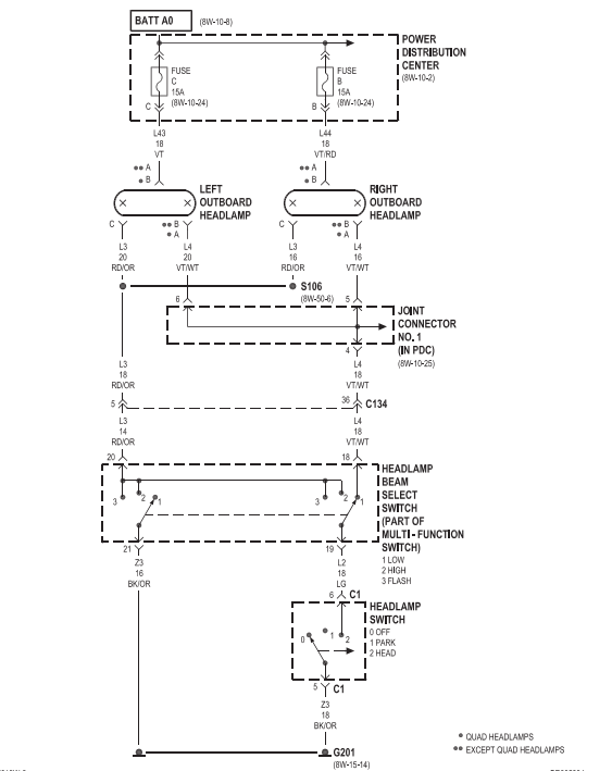

BUT   the ground for the headlights is G201.  (this is a 2001 manual but yours is probably similar.
The headlamps are sent constant 12v (even with key off.)  the headlamp switch and multifunction switch allow the bulb to "see" ground to come on.  For there to be a difference on the ground side it has to be the splice S106.
To set up a test of whether it is the ground or the hot side, use a different headlight bulb from another car with a socket.  (I have cut a couple of these from junk cars.)  put some long leads on it.  Connect one lead from the test bulb to the battery positive, and connect the other lead from the test bulb to the suspected socket ground.  If it lights bright, ground is good and positive is suspect.  If it is dim ground is suspect.
Then reverse the test light bulb.  One lead on battery negative, the other lead in the suspect socket positive.
Another thing that can weird out the headlamps....  did someone swap a 9004 bulb for a 9007?   I don't remember which one is correct, but the socket is exactly the same but the filaments are connected to different pins. (if you don't get it, swap the bulb from your right headlamp to your left,  did the dim bulb follow the move?)

HAGGAR, that diagram, like all I've found, shows the system with two 15 amp fuses...mine is a single 40 amp marked for headlamps with no others to be found in cab or under hood.
