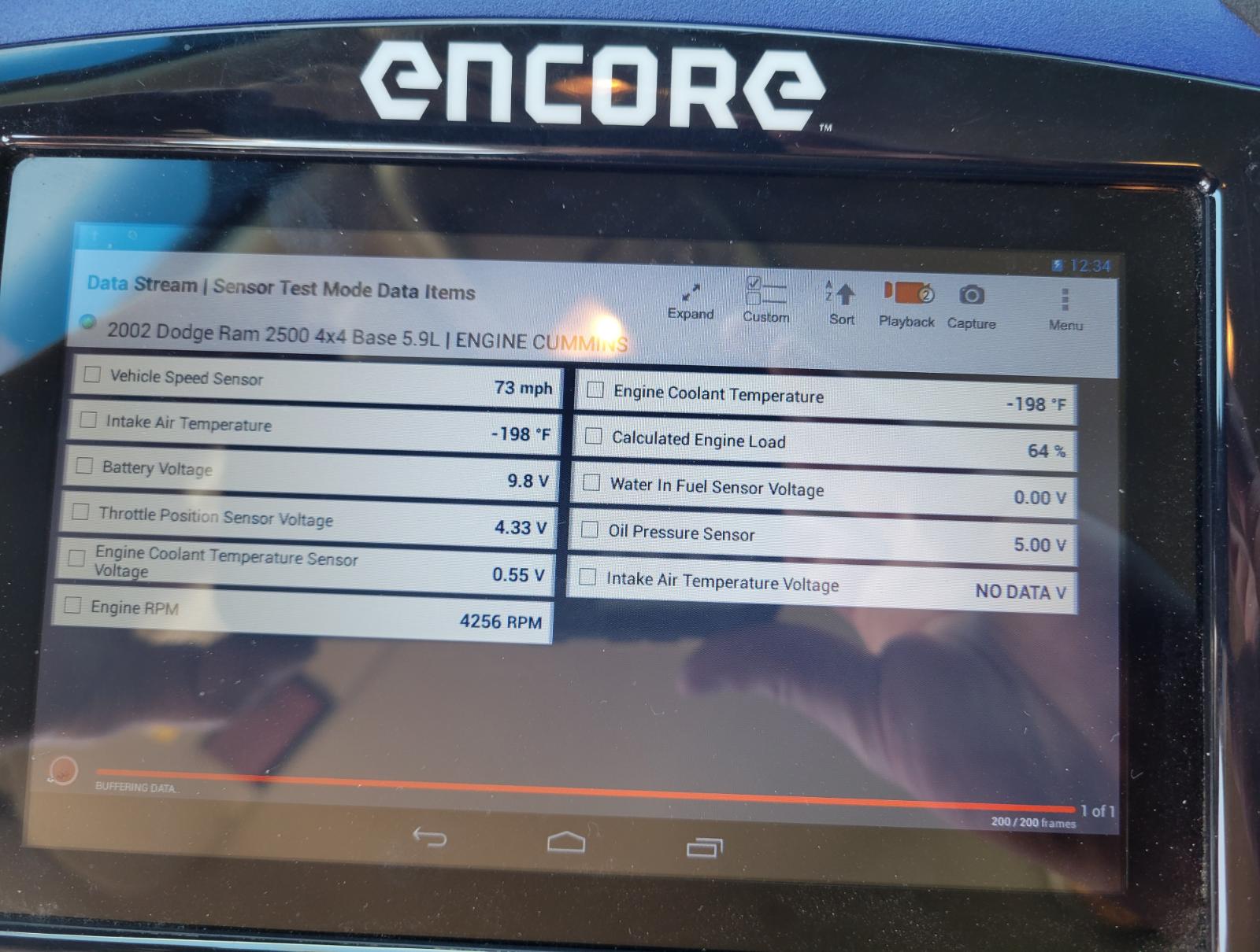

So I thought I'd repost this here. Yesterday I was driving down the road and the truck just died.  It threw a p1693 and then a p0122 and p0237.  Battery voltage was showing 15.1 and the IAT was showing 2.70v and the engine temp was 2.79v.  The scanner was showing no data from oil pressure sensor.  The Map and IAT and apps are all brand new. I unplugged the quadzilla and it made no difference.  I'm thinking Ecm??? Wiring?  This picture 20210418_123457.jpg.42a400bff94348787fda44d456d7bbfc.jpgis what the scanner was reading when the truck died.  The truck would run for a few mins and then die, but now it will only run for about 5 secs.

Saw this in your other thread.  That info appears whacky to me, unless you were turning 4256 rpm.  I would not believe on them. Get the codes read and lets see what the truck trying to tell you. A p0606 would be a definite ECM failure, but we dont see that code tripped very often.. Mine did not trip it when it failed. but the first rebuilt one did.

How did you test the charge voltage on alt to get the 15.1 volts? The photo above shows charge voltage at 9.8 volts. Either is not good. To high is harsh on the charge system and to low will make the electronics act weird. Your alternator could also be putting out to much AC voltage. This can harm the electronics. These trucks need good clean DC power to keep them running right. There is also an article by a member named WT. He has a very good article about a ground mod the cheap simple to do. He goes quite about this issue. I would link but for some I cannot access the articles section.

@Tractorman is right. Thats why I asked a few posts back. I dont know how you got the 15.1 reading. The encore says 9.8, You are going to have slow down and not just throw another part at the problem. When my ECM failed I spent 2 months trying to figure out what the problem was. I bought a VP and a Timbo apps and neither fixed it. I quit throwing money at then. A new ECM did fix it but I was out of my league on the problem. Finally found a shop with very knowledgeable owner who helped me when the second reman died. Got luck on that one.
Sorry, let me explain, the encor showed 9.8 when it died and 15.1 while it was charging.  I still need to do the wt mod so this might be the right time to do it and get that out of the way. Going to try different ecm tomorrow and see if that helps and if not, then on to checking the wiring.

I presume an Encore is a scanner ??  and I also presume voltages were 15.1 running and 9.8 engine stopped  if so then running is too high and stopped is too low. Stopped I'd be wanting to see 12.2 or 12.4 ish without the heater blower is on and everything electrical is also on
I'd be checking batteries/cables etc if that stopped figure is right.
