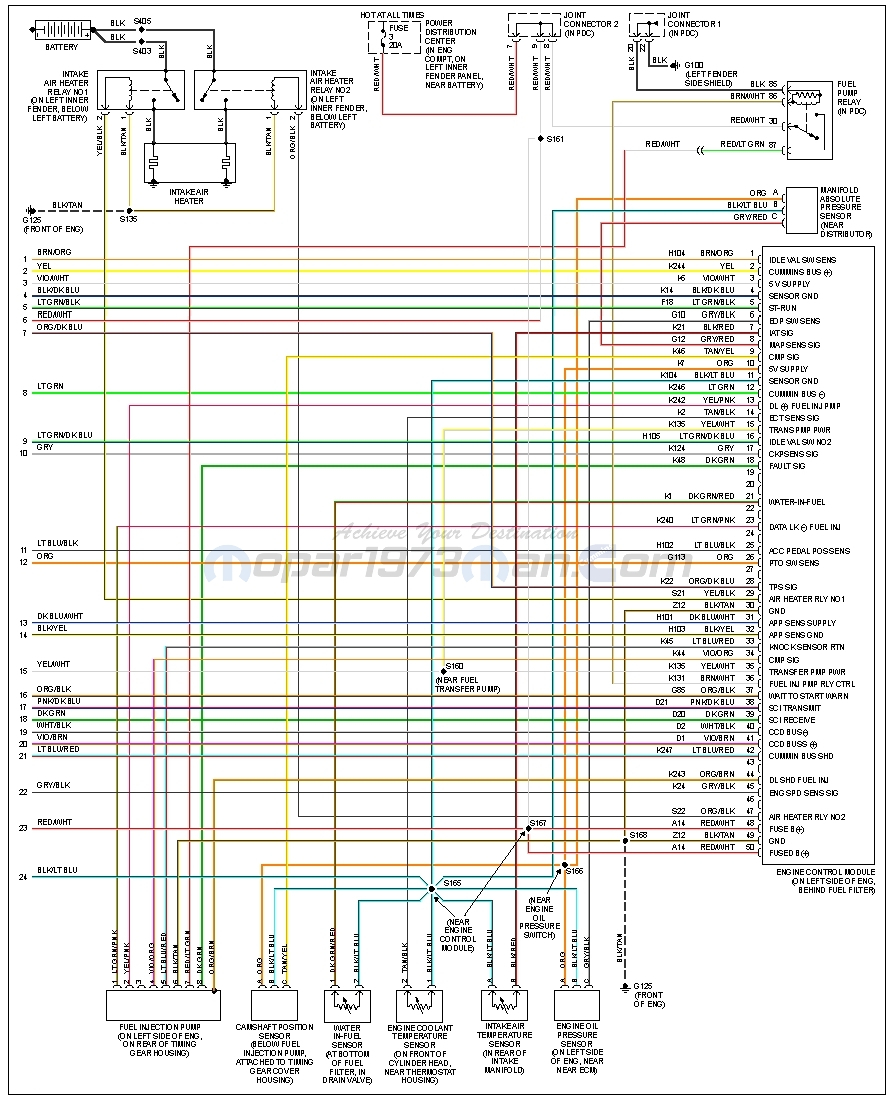

All the wiring maps are here. 3 pages of grounds for these trucks.

As for ECT sensor it supplied the +5V and sense on the same lead. So when the sensor is unplugged the ground reference is gone so the temp should max out like it did this is normal. For the ECM to report -40*F means the sense lead is shorting to ground. That is the only way to drop to low volts.
I didn't see any mention of reading codes. Could you grab a OBDII reader and list all the P codes here it would help.
Don't thing its unusual to see a internal short inside the ECM. I've seen cases where the +5V reference is gone or it seems like every one of the sensor shorted to ground. Worse yet to have the ECM either all hi volt or lo volt codes for everything.
Take notice that the ECT sensor is sharing the sensor ground with other sensors. This change through the years but not by much.

If the S165 ground is bad, being that it is shared by the ECT and Cam/crank sensor (if applicable to 98.5 models), then I would think fixing the ground would fix both issues.

Ok my suggestion is to pull the ECM plug and test with a ohm meter between the ECM plug and the ECT plug it should show 0 ohms. No more than 5 ohm is allowed. Now you do one more test leaving both plugs open. Test between a pin and ground to verify there is no wire shorted to ground this should show infinite ohms or open circuit. If any ohms show then there is a short to ground. If these two test are OK. Then you need to send the ECM in for rebuilding being the problem is most likely internal.
