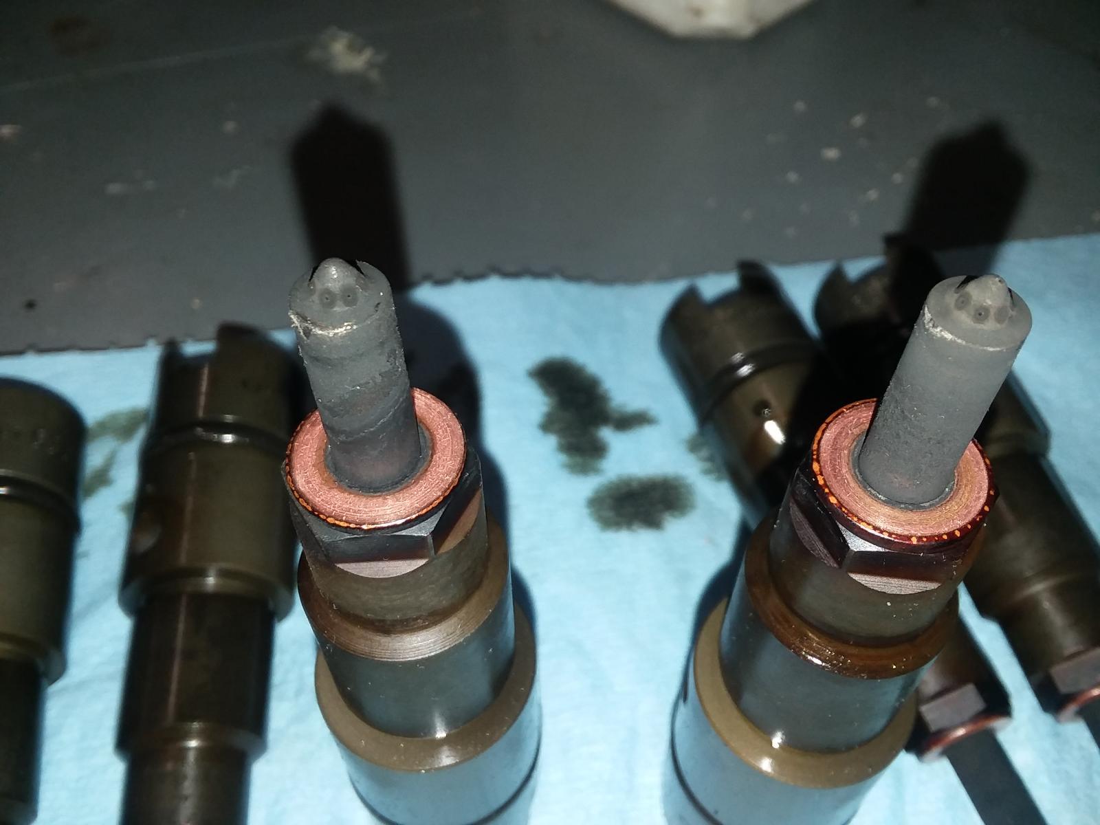

On my personal truck, I ran the OEM injectors for 303,000 miles.  I only changed them out because I thought it was time and they had served me well.  The engine rpm had never changed at idle throughout the life of the injectors.  Fuel economy was always very good, the power was very good, the exhaust was clean (for this era of engine), and the engine always started fine in cold weather right up to the time that I replaced the injectors.  In fact, when I replaced the injectors with RV275's, I really couldn't tell any performance difference other than the RV275's delivered a little more torque on the low end, but engine idle was the same - smooth, and at the same rpm,
The OEM injectors (303,000 miles logged) are shown in photo below.  In my opinion all of the injector tips looked very clean for the miles logged - no evidence of poor performance on any of the injectors.  The appearance of the other four injectors looked the same as the two injectors in the photo.

@Doubletroubleand @Mopar1973Man, I appreciate your prompt replies.  I agree on many of your points regarding the life of an injector over time - specifically the weakening spring (lower pop pressure) and the internal needle and seat wear.  I also understand that the injector tip holes can erode over time.
I am in touch frequently with two other Dodge truck owners - one with a 1999 Cummins and the other with a 2002 Cummins.  The '99 has 295,000 miles on the original injectors.  I have recommended that he replace his injectors.  The '02 has has 185,000 miles on the original injectors.  Both of them still perform well and both of them have not experienced any change of engine idle rpm.  So, what gives here?
@Mopar1973Man, is it possible that this engine load / rpm change that you refer to is more evident with aftermarket high horsepower injectors and not with stock OEM injectors?
Just my opinion, but I think the average life span for new OEM injectors for this era of engine would be closer to 200,000 miles.
